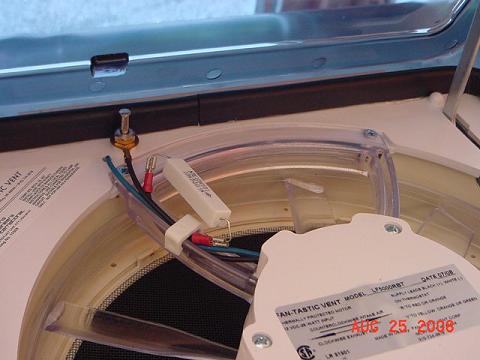

I got a 5.1 ohm resistor today and spliced it in as directed in the tech bulletin and it seems to work fine. I'm going to try a slightly higher impedance and see if that is better yet. The 5.1 ohm is still a bit faster in the lowest setting than I'd like to have. I took some pictures of the install but left the camera in the garage tonight. I'll get it tomorrow and post them. It's a real simple mod to do and is easily reversible if you do not like the results.

Here is how I have it so far. You can see I used some spade connectors I had lying around that I crimped to the cut wire. The resistor leads push right into the female spade end. This will allow me to swap resistors easily until I get the fan speed I want. Once I get that settled I think I can simply crimp that one half of the spade and have a good solid hold on the resistor. I bent the leads to get the required offset from the fan support leg to hang it out in the airflow.

Tried a 10 ohm resistor yesterday and honestly I can't tell much of a difference between it and the 5 ohm. Both are a big improvement though for anyone looking to quite the hovercraft like sound of a stock Fantastic Fan in a little camper. Our next trip is a few weeks away so a field test will have to wait.
They cost me a buck each, so it's a cheap mod too.

A PWM controller _would_ be superior. BUT a simple resistor is fine.
I just want to reiterate the "hang it out in the airflow" comment -- that resistor is going to get really quite hot - it's a ~6 watt electric heater. So don't let it stick to the plastic, etc.
In the airflow it'll be fine.
