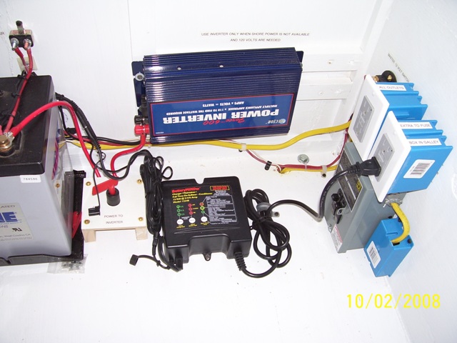

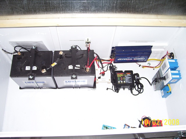

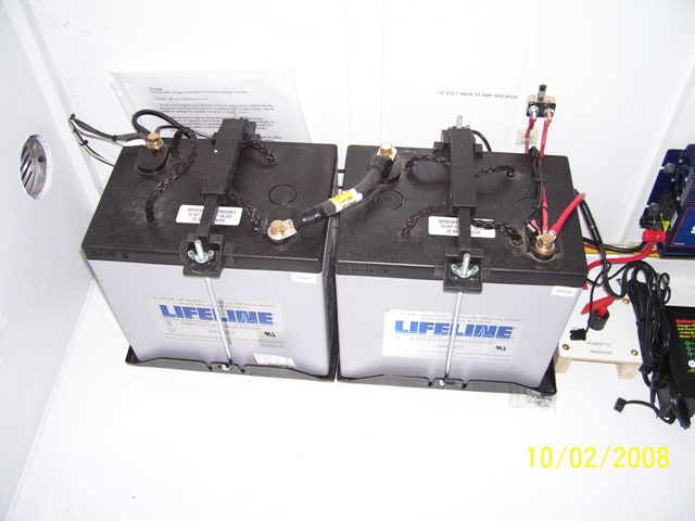

Postby jamesm » Thu Oct 02, 2008 12:39 am
I have two of these..GPL 4CT batteries (2-6 volt AGM batteries) in my tounge box with a dedicated charger. Plus I am going to hook up my TV to charge the batteries as I drive. I'll get a pic tomorrow as its to late now. I have used the batteries only twice for weekend camping. They have lasted all weekend then when I put the digital volt meter on them it shows a full charge. I have a inverter that I use to run my laptop that I use to watch DVDs and I run lights. So not a lot of draw...but plenty of reserve to last a long time.
Here is a link to the specs on the batteries I use. http://www.lifelinebatteries.com/rvflyer.php?id=14
Here is the link to the charger I use.
I thought it would be helpful to see how the dual batteries can be set up.http://vdcelectronics.com/batteryminder_12248.htm
