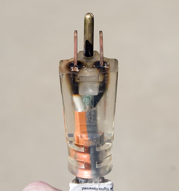

Postby caseydog » Fri Nov 06, 2009 1:38 pm
Well, I went out to take a pic of my cord, and it turns out that on mine, it was the MALE end that got a bit toasted, not the female end. Getting old sucks.
So, in my case, it was probably a problem with the park's power outlet, or rainwater getting to the park's power outlet.
Here is what mine looks like. This is a 12GA Rigid (Home Depot) 15 Amp cord....

Postby CASHCOW » Fri Nov 06, 2009 10:25 pm
caseydog wrote:Well, I went out to take a pic of my cord, and it turns out that on mine, it was the MALE end that got a bit toasted, not the female end. Getting old sucks.
CD
CD it looks like to me you just let the smoke out of your cord :lol: :lol: :lol:
