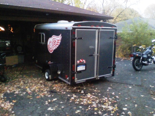

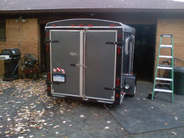

I installed tractor type lights on both sides of my trailer just aft of the fenders because I have a narrow drive that goes around to the back of the house. I have been using the brake lights to light my way for some time now but with having a manual transmission and all, it becomes difficult to operate the clutch, gas and brake pedal all at the same time. Last fall I installed some LED strip lights just to help out a bit. It's still in the garage so I can't say at this time how well this combo works but I am sure for my application it will work just fine.
Darn cell phone camera's :x
