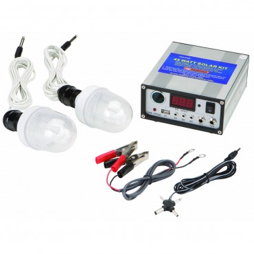

Postby bobhenry » Wed Feb 01, 2012 10:45 am
Does this even look safe ????
Looks like large PA type plug on these LED kit lights on this Harbor
Freight package system. This might be an answer to the receptical
question but for some reason I am just not real comfortable with it.
My guess is if used the hot would be the tip and the ground would
be the shank ????
Standard AC switches could be used to control them or a
standard toggle type switch.
For the last 4 days I have been trying to educate myself
on the wonders of photo voltaics and I am getting more
and more confused.
For the $$$ the 45 watt Harbor Freight system looks like
a good buy.
I know, I know ( insert HF insults here ) !
I intend to be off grid with the caboose build and desire
12 volt lighting, power ventilation, and a few electronics
such as radio and TV. I am curious just how many ganged
together backup batteries this system would manage.
I have almost come to the conclusion that 2 seperate 3
panel systems with 2 sets of two deep cycle gel batteries
each would be better than trying to gang all this together.
This way I will have a totally seperate "back-up" system
and simply toggle from one feed to the other.
Just how far off track am I ??? :roll:
Postby Shadow Catcher » Wed Feb 01, 2012 12:43 pm
HF is never a good buy for solar. You can find good panels at less than a dollar a watt. I picked up a 144W Unisolar panel and PMW Steca (German made) controller for less than $150 including shipping. This is a special case and the panel is about 10' long flexible used on a house in place of shingles, I had to soak off the glue, but it does work well and can be rolled up and stored.
I made some serious mistakes in my ignorance i.e. the big panel mounted to CR puts out 50+ volts because it was meant for a grid tie which required a MPPT controller at more than 4X what a PMW would have cost.
You also need to do the calculations on need and understand what you can realistically expect from solar. And learn from our mistakes :roll:
