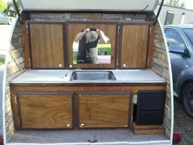

Can someone please post some pictures of their PD4045 actually installed? I'd like to see where you put it and have the shore power inlet, etc. Most people seem to put this in their galley cabinets somewhere? Thanks so much.

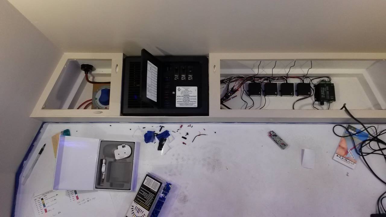

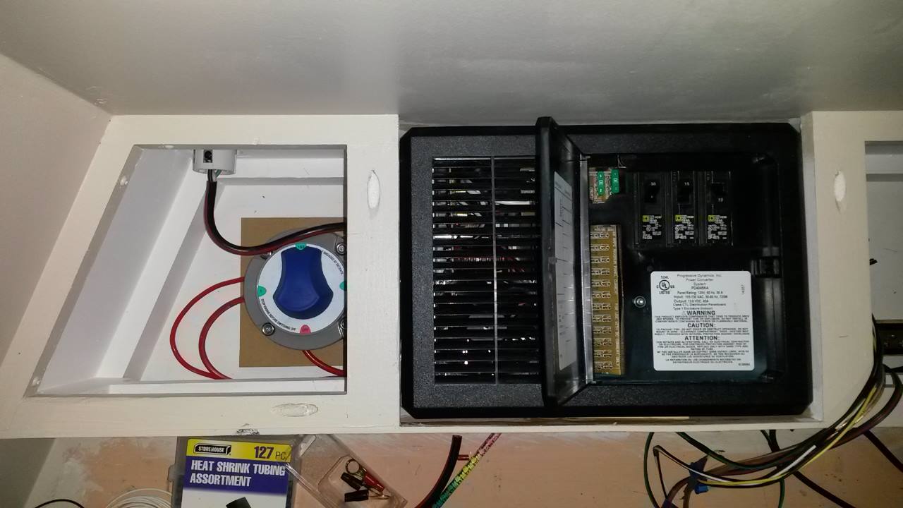

jandbsteardrop wrote:Hi,
Jack
I've always been a bit different, but my electrical compartment is at the head of my bed.
The power inlet, meter, and battery switch are just to the left of the power center.
I still havent finished the compartment cover, but when finished will still allow for air circulation above the power center.

Here is mine installed in the galley
