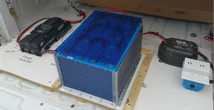

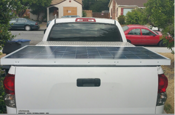

Postby OverTheTopCargoTrailer » Sun Jul 19, 2015 6:36 pm
There is tear drop solar
& then there is OTTCT Tundra solar, 300 watt panel, 300 ah Lithium
Screen shot 2015-07-19 at 4.29.13 PM copy.png (135.05 KiB) Viewed 1661 times
Screen shot 2015-07-19 at 4.28.42 PM copy.png (165.17 KiB) Viewed 1661 times
