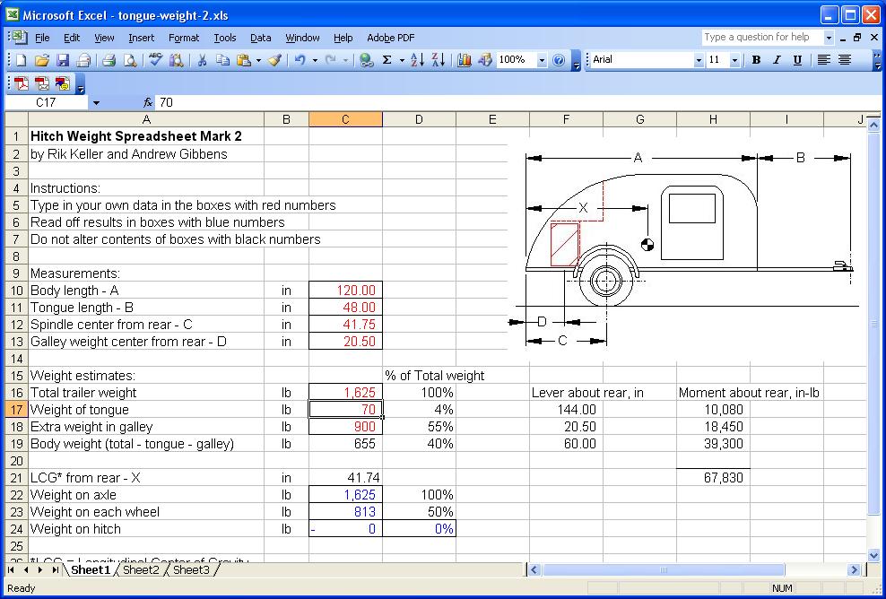

This must be the answer for anyone who's tongue weight is too heavy.
GeorgeTelford wrote:
Look Ma... no weight on tongue...
