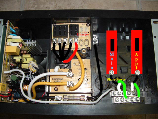

Here is I understand how to hook up the converter.
and here is how I understand with a Main
Here is a question, though. What happens if you hook up a line from the battery onto the yellow line (power line for 12V in the pic with the screw)...would this effectively make it an INVERTER also when shore power is disconnected? I am sure it wouldn't, but never hurts to ask. Or is it already doing this when it is not being charged (my red charging wire that goes to the battery)? IE: does the 110v work when not on shore power and working off the battery?
If it did, the breaker(or Main if 2 breakers) would have to be shut off, so as to not have a charged line to the plug.

Postby JIML1943 » Mon May 29, 2006 4:10 am
dacrazyrn
That unit is a converter only (110v ac to 12v dc) with battery charger, not made to be used as an inverter. Will not invert 12v dc to 110v ac.

Postby dacrazyrn » Mon May 29, 2006 6:19 am
what I had figured...why I do have the inverter that I plan on using. Thanks.

Postby dakotamouse » Wed Jun 07, 2006 6:39 pm
We bought one of those Centurion converters too and were dismayed to find no instructions came with. :?
BUT Thanks to some wonderful help from Gratis we are installed and it all makes sense! :thumbsup:
I hope he doesn't mind but this is a copy of the instructions he sent us.
Don't feel bad, Mine came the same way. It is still sitting on the shelf in the garage since I don't really have more then a frame and two walls right now.
This is what I was able to figure out so far.
12V
Lug A: Goes to the battery and the vehicle hot wire
Lugs B to G are for 12 V circuits. They match up with the fuse holders so no biggie there. You just run all your positive 12V wires to their own lug and install a fuse.
All the 12 V grounds go to the lug strip on the back of the unit. I believe that this lug is also meant to be grounded to the trailer frame if you like.
120 V
From shore power:
Hot (black) wire goes to the lug up at the top right next to where the breakers install. This will make the blades hot next to it. Make sure you have the black wire going over to the charger included on the lug.
Neutral (White) Goes on the upper lug strip on the bottom under the breakers. There should be a white wire hooked up there already for the charger
Ground wire hooks to the other Lug strip on the bottom.
For Each 120 V Circuit:
Black wire goes to Breaker Lug
White wire goes to upper lug strip under breakers
Ground goes to lower lug strip under breakers
I hope that helps. I am going off memories from a few years ago when I wired a pop-up camper with this same converter.
Now is also a good time to get the ratings off that small glass fuse inside the unit so you can stock a spare. Those have a tendency to go out at the worst possible times leaving you with no 12V DC.
Good Luck!
