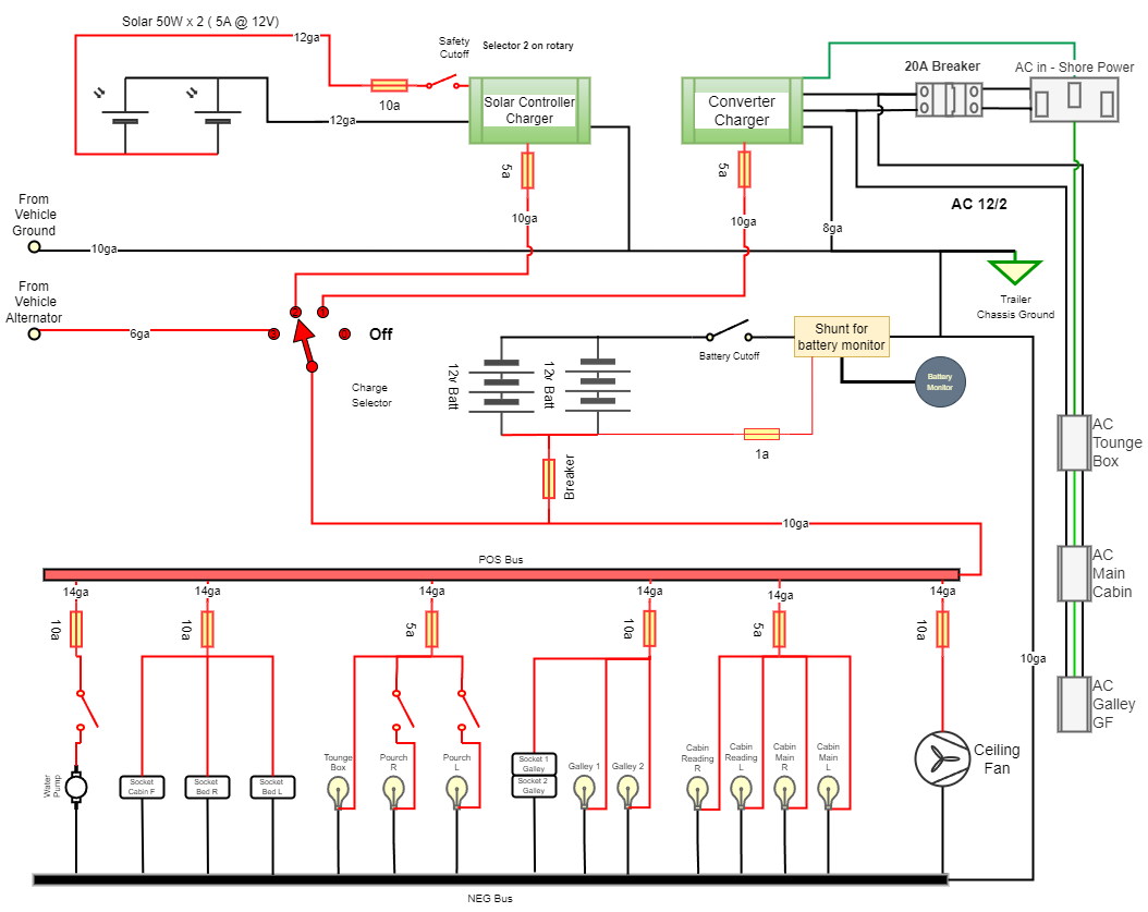

Postby BLTillson » Fri Feb 10, 2023 12:31 pm
I have been melding all this advice (and melting my brain) working at getting it all correct on the schematic. This is my current iteration.
Main Electrical Current State 021023.png (103.03 KiB) Viewed 562 times

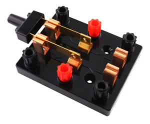

I am still working on the solar disconnect issue.
Maybe I need something like this! :thinking:
DP-Drop Switch.png (64.5 KiB) Viewed 562 times
Kinda has the mad scientist feel.

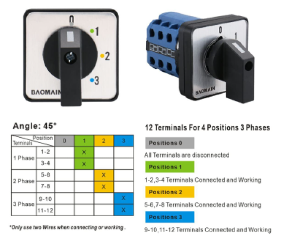

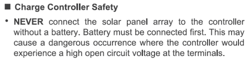

Postby BLTillson » Fri Feb 10, 2023 1:56 pm
Tom&Shelly wrote:Ah yes, I missed the note in your schematic. Then the concern is whether one part of the switch breaks (opens contact) slightly before the other--maybe just a matter of milli-seconds--when you turn the switch, and how critical is that really to the charge controller? I don't know the answer to that. It might be worth a call to the charge controller manufacturer. :thinking:
I have been racking my brain on this. It occured to me that I could use DPDT switches to guarantee that the battery was always connected when the solar panels were disconnected. That being the warning.
Controller warning.png (35.5 KiB) Viewed 543 times
Then I thought, since the rotary switch I have is not a simple one to many switch, What harm would/could there be if the battery were always connected to the output of the solar controller? Then I could just use those poles to control the connection of the solar panels. :thinking:
Rotary Switch.png (173.67 KiB) Viewed 543 times

Postby Tom&Shelly » Fri Feb 10, 2023 6:59 pm
BLTillson wrote:Then I thought, since the rotary switch I have is not a simple one to many switch, What harm would/could there be if the battery were always connected to the output of the solar controller? Then I could just use those poles to control the connection of the solar panels. :thinking:
Well, there are folks on here who know lots more than I do about teardrop wiring. I believe it was one of them who told me it was okay to connect the solar controller output and converter output to the battery at the same time and leave them connected. In the event, that's what we did, and both the controller and converter are still working fine. It does make sense, since neither knows whether the voltage on that output line is from the other box or the battery.
Anyway, I'd do what you just said. :thumbsup:

Postby BLTillson » Fri Feb 10, 2023 7:32 pm
Tom&Shelly wrote:Well, there are folks on here who know lots more than I do about teardrop wiring. I believe it was one of them who told me it was okay to connect the solar controller output and converter output to the battery at the same time and leave them connected. In the event, that's what we did, and both the controller and converter are still working fine. It does make sense, since neither knows whether the voltage on that output line is from the other box or the battery.
From what I have learned and what I have been told that seems to be a great solution. Alos, with my battery disconnect switch the there is no danger of battery drainage when not it use. Are you saying that you have your converter and your solar controller feeding the battery simultaneously?

Postby H.A. » Sat Feb 11, 2023 8:01 am
Fwiw,
At my equipment shed I keep my tractor plugged into a solar controller. The solar array is never disconnected but often I bring the tractor back in after dark.
To prevent a battery being "connected first" scenario, I have a 4Ah battery what's always connected to the solar controller.
The tractor simply plugs in parallel with that battery every time its parked.

Postby BLTillson » Sat Feb 11, 2023 8:56 am
Fwiw,
Thank you for that. We did come to the conclusion that I could just leave the solar controller connected to the battery (+). I would have a selector that disengages the panels while connecting the converter output simultaneously. Since the solar controller and the converter have staged charging cycles I am not going to have them connected to the battery at the same time charging. From my best understanding that just feels like I am going to introduce issues in charging and possibly abuse the batterie$. $>
I am working on the final schematic updates and will post then when we are at the end of this thread for the good of all future teardrop builders. :)

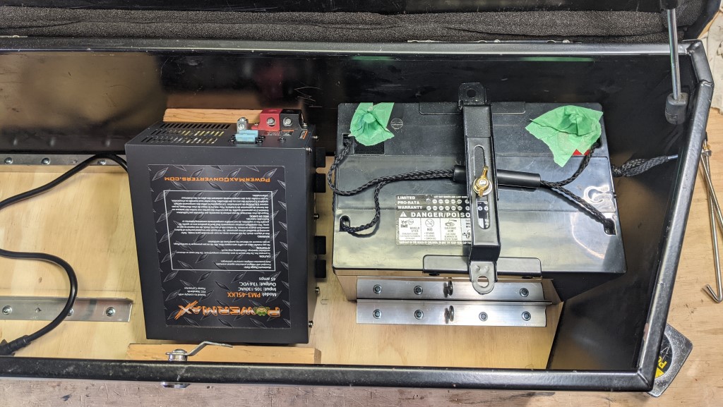

Postby BLTillson » Sat Feb 11, 2023 11:21 am
Speaking of batteries... It just dawned on me, you're planning on two batteries. What type and why two?
Greetings and good morning. 8)
AGM, 75Ah. Two for more battery life, if needed.
I am starting out with one and see how that works for maintaining power. If I need it I can add another. I have already setup the tongue box to accept another. If I don't need the second battery I can store jumper cables and such on the other side. :D

Postby tony.latham » Sat Feb 11, 2023 1:04 pm
AGM, 75Ah
That's the same size battery I'm running, and it's more than enough juice for us if we camp in the deep timber without sunshine for four or five nights.
With sunshine, we can go forever.
:thumbs-up:
Tony :beer:
