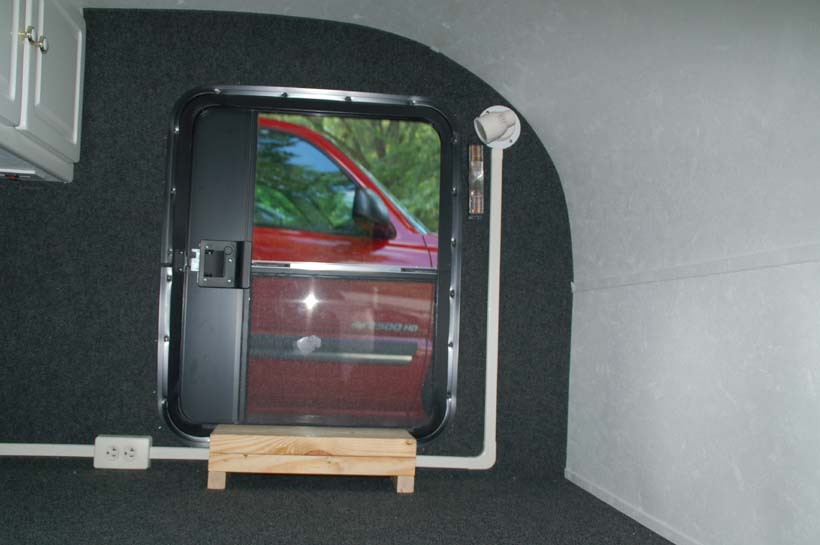

I too enjoyed this topic and I am sure Miriam did not mean to whack anyone. Bobhenry’s comments and everyone else's have added a lot to my enjoyment as they made me feel better about the way I did my trailer wiring. Even comments representing opinions at the other end of the spectrum were helpful, persons not wanting to even put A/C and D/C in the same trailer.
What I did was mix A/C and D/C wires in bundles and small raceways similar in size to conduit. I did try to keep the connectors/connections for A/C and D/C in separate junction boxes. The idea of dual voltage lights may cause me to re-think that. 8)
This photo shows an A/C outlet with D/C wire passing through to a D/C light, no break or connection in the D/C wire until the light.
Although I have not done so yet I want to try the D/C light with an electric blanket or other A/C item plugged in, looking closely to see if there is a flicker in the light. I doubt there will be. The rectangular light is a LG factory original that runs on AA battery. Seldom used now.
