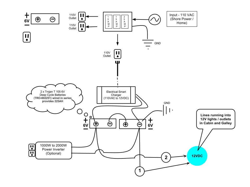

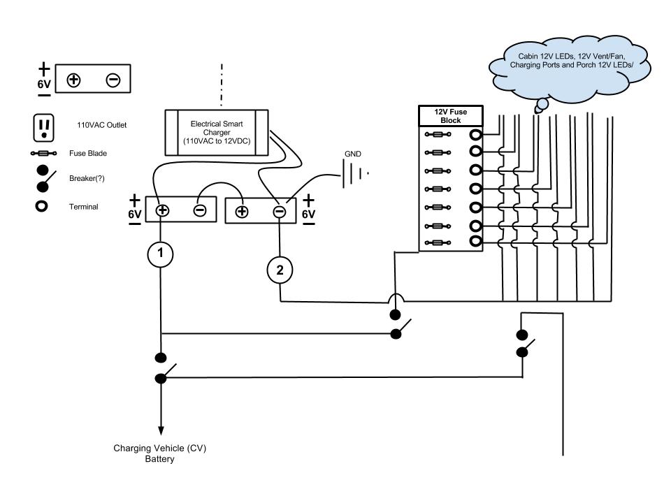

Postby IslandStorm62 » Wed Jun 26, 2013 1:09 pm
I am also trying to figure out theproper electrical system to apply for my TD. I stumbled across this youtube video and thought it might be fairly simple and kinda clarrifies a few questions I had. I was trying to capture the wiring diagram and reproduce it for my purposes, but in additon to my minimal IT skills, I also have poor penmanship and was only able to draw out the first few blocks. :cry: I got lost when trying to draw out the 12v system. Yes it is based on a 220vac connection, but really, even I can figure out where to go 110vac 8) . Again hope this helps anyone trying to figure out the 12v wiring. I suppose it is similar to what Desert Dawg(sp?) has published, but I am not entirely sure. The question I have is on the need for different fuse amperage's (3a, 5a, 10a, 15a, etc).I could not deytermine what the amperage's of Desert Dawgs fuses were...anyone out there have an idea?

Little curiosity here? I have very limited experience with full hookup camp sites. I've only rented two trailers in my life and one was used only at a primitive site. So basically, with the other trailer, all I did was drive up, plug in and settled down for a couple days. I did not pay any attention to how many or what types of outlets were available. So, if any of the more seasoned full hook-up campers could help me visualize what I should have seen, had I paid attention, perhaps I can understand better.
The Super Simple Electrical System sounds and looks great. I suppose, if a feller wanted to, he/she could dedicate one of the outlets to the battery bank (Smart Charger), that would be providing power for the 12VDC lights, fans, outlets, etc. Which could work out great. I won't have to install a Breaker Box with 20A and 15A Circuit Breakers.
I guess my question is based on a part of the thread where the discussion turns to melting your power cable or needing an adapter for those high speed 30AMP Outlets.
If this is an issue, why use a 12/2 GA Plug/Inlet? Don't they make these cable in a more compatible guage?
Are the outlets at most campgrounds "TYPICALLY" 30AMPs requiring a special trailer inlet and 10 Gauge power cord to connect with?
Do the campgrounds not provide regular household outlets, like most of us have in the garage?
I've copied and modified a electrical wiring diagram, that I am still trying to filly understand. However, if I do not need the Electrical panel, then I can change things now rather than later.
TD Wiring - Pg 1.jpg (54.21 KiB) Viewed 17594 times
TD Wiring - Pg 2.jpg (54.16 KiB) Viewed 17594 times

Re: Super Simple Electrical System
Postby bdosborn » Thu Jun 27, 2013 12:50 pm
I think you missed the title of this thread:
:shock: ;)

Postby IslandStorm62 » Thu Jun 27, 2013 12:56 pm
I suppose you are correct. To keep it within the thread, will this super simple electrical system make an adequate substitution for the two 15AMP and one 20AMP Electrical Panel I was / am planning on? it is on the top of the First Diagram.

Postby bdosborn » Thu Jun 27, 2013 1:02 pm
Probably, unless you have a bunch of big electrical loads (like A/C, electrical skillets etc.). It's certainly plenty for the battery charger.
