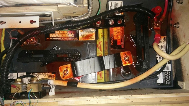

The technology will be mature (IMHO) when you start seeing golf courses use them. That will signal to me that the maintenance and cost-to-use is better than what I'm using currently.Besides, I just made a cool battery inter-connector out of solid copper strapping I bought off eBay....

Can you share a photo of your inter-connector? I am interested in seeing what you built.

Yup, only I had to bend it up in the bench vise to clear the second terminal. I wrapped it in electrical tape just because it seemed like I needed to:
All the red stuff is anti-corrosion spray. Keeps the terminals acid free.

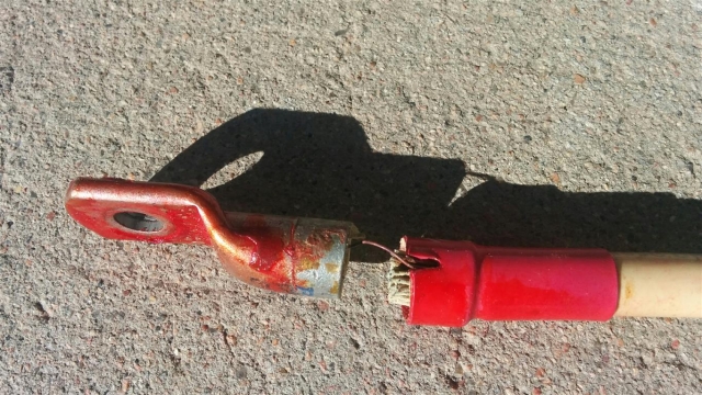

I had to replace the existing cable because the battery walked and separated the end. Only one strand of wire was carrying the entire battery current. It must have gotten kind of hot as the shrink tubing is melted.

Thanks for your photos. Glad you did not have a fire.
I like your copper inter-comnectors.
I would have considered them for my four 6 V battery box I plan on building. But I just ordered my complete set of 4GA custom made battery cables.
I am learning from your experience and will make sure the batteries are nice and tight and secure.
