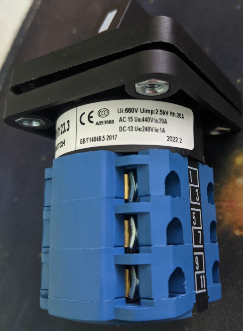

featherliteCT1 wrote:
BLTillson wrote:
featherliteCT1 wrote:How do we know the switch is DC rated?
The specs on the switch do not specify AC or DC Simly a voltage and amperage that are within my circuit limits.
Regula generalis: si nulla DC specificatio, non DC aestimatio :NC
I think it is so important in life to admit when we are wrong and make sure those who correct us are thanked and proper apologies and repentance are observed. As I was working on my wiring diagrams (as opposed to my logical diagram posted here), I ran into a question of the amperage that the rotary switch I had selected would handle using DC voltage. featherliteCT1 had warned that my selection may not have been adequate for the intended task. I found the evidence that was missing that proved him correct. The crazy part was that it was printed on a label on the side of the switch. This was not in the specs or box by the way.
Rotary Switch.jpg (115.25 KiB) Viewed 302 times
I can still use it but I am probably going to use it to control the AC input to the converter instead. That is even a cheaper solution in regard to wiring since I have to use a lower gauge. So I stand corrected.

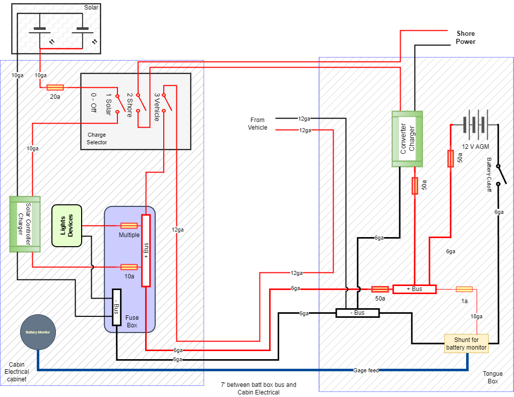

Postby BLTillson » Tue Feb 28, 2023 12:43 pm
As a follow-up I wanted to post this diagram. I took all the information I was given and converted my logical schematic into a wiring diagram. This was needed for actually planning out the trailer wiring. Should have started here but the only thing I knew was schematics having worked in electronics for a while many years ago.
Main Electrical Wiring Diagram.png (159.86 KiB) Viewed 276 times
Funny thing, It actually looks simpler in this format. :thinking:
