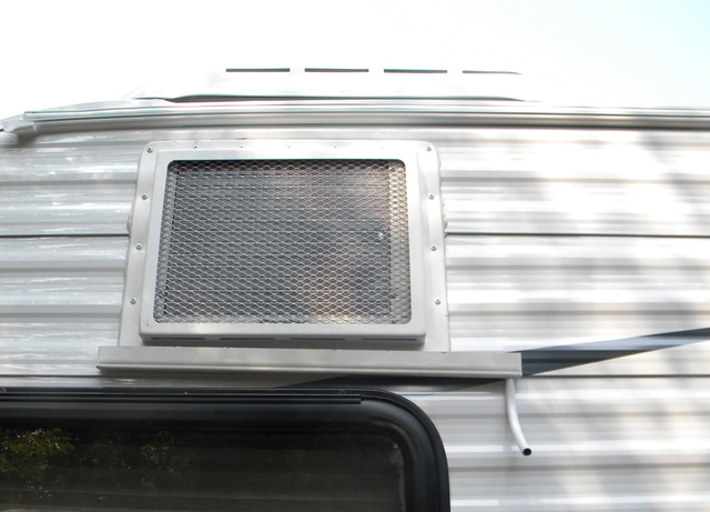

a side ac unit.jpg (119.26 KiB) Viewed 8930 times
Above the window you can see the a/c is almost flush with the exterior ...
thats the way I want it , on the roof you can see the refrigerator vent - used to suck in the cooling air.
Now for my Crazy idea
Now for the tricky part.... I want to cut a hole into the side metal upper most wall for a 12" tall x 16" wide 5,000 Btu A/C unit.....
On the exterior the A/C grill will be even with the exterior skin or stick out maybe 1/2" "Like above"

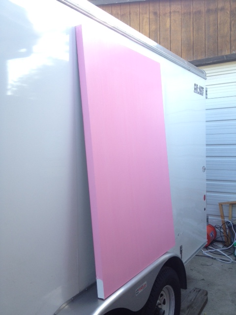

The pink is the solar panel cover "with the plastic" still in place to protect the cover.

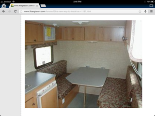

Here you see the a/c inside a small cabinet - this draws air from the vent on the roof.
