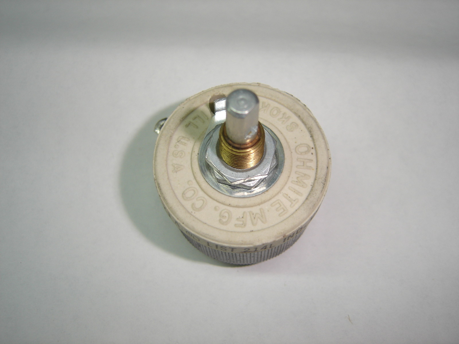

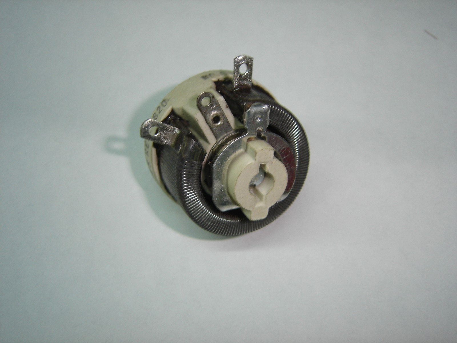

I experimented with various electronic dc motor controllers on my fantastic fan. Although they would slow it way down, the fan always made irritating noises at the lower speeds. The manufacturer publishes an app note recommending high watt resistors to slow it down so I tried the 50 ohm 25 watt Ohmite industrial rheostat in the pictures (~$12 on eBay). With this, I can slow the fan to a crawl and it stays whisper quiet through all lower speeds. I can get a very pleasant mild draft at the slowest settings with one window cracked open. The rheostat small size is pretty much a direct swap for the original 3 position switch and adds infinite speed control settings. No rewiring or adding components and, unlike the solid state controllers, works in both directions. I use the middle position of the In/Out switch to turn the fan completely off. The rheostat windings do not heat up as much the resistor wires did on the original 3 position switch either and, I don't notice much difference in battery use from before when it had the orig 3 position. Hope this helps.
[img]file:///C:/Temp/rheostat.JPG[/img]
[img]file:///C:/Temp/rheostat_2.JPG[/img]
[img]file:///C:/Temp/rheostat_3.JPG[/img]

try uploading images again...
rheostat_3
rheostat
rbtrary

Postby woodi » Wed Jun 05, 2013 9:57 am
Awesome. Just did a search on ebay and see there are still some for sale. Might just have to go that direction. Have you found the 50 Ohm one to be a bit overkill? Does the fan cut out before you've dialed the knob all the way down or just make it down to a real slow tick? I just worry about the knob getting turned down too far (if it can be) and thinking it's off when it's actually just getting fed voltage bellow what it needs to run.
