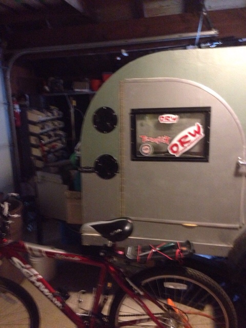

Postby Socal Tom » Sat Apr 11, 2015 12:35 pm
Ok it's in test mode . It's only supposed to be 68f here with 70% humidity, so not a real tough challenge, but I did put a humidifier inside to try and push the icing. The plenum is cardboard and I borrowed the 5 inch hose for supply from a portable unit we have. The return is currently a 6 inch flex hose I got at the depot. Putting the supply above the shelf makes a big difference. Sitting up the air hits you in the face, but laying down nothing. I can hear the air blowing, but it's not any louder than when it was at our feet in the bulk head. I probably won't hear the compressor cycle now.

Postby Socal Tom » Sat Apr 11, 2015 1:43 pm
Here is the picture . I'll have to wait until it warms up and I source the final hoses before I really test it, but fr a noise standpoint I think it will work

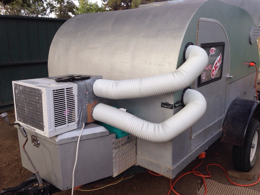

AC Hacking a Figidaire 5000 BTU
Postby Socal Tom » Sun May 03, 2015 8:19 am
Here is a picture of the system in action. It's still a prototype so the plenum is cardboard. It was about 85 outside when I ran it, but it cooled off by night fall so I didn't run it at night. Though I'm not worried about it being a problem at night. There is the sound of air blowing, but it's not bad, and the supply is high enough that it only blows on you if you are sitting on your knees.
Finding hoses was the most challenging part of the build they end up being 5" OD and about 4.5 ID. With a couple of wraps of duct the the "thread" into the 5 inch deck plates. So fat right think it cost$60 for the mod, but the plenum cost is still to come.

Postby Shadow Catcher » Sun May 03, 2015 2:34 pm
Tom what are you doing for condensate or are you just going to keep it as a slinger. I am not a fan of the fan getting rid of condensate (noisy and drilled a hole to let it drain).
