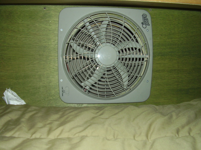

ok folks I got an electrical gremlin in my cabin fan,,, it one of the 12 volt, battery units from Wal Mart,, you know the ones that are battery powered or 12 V ac adaptor,,,,here is my situation,,, I cut the battery pack and battery tabs off, I mounted the fan in the footwell and hard wired it in to my 12V system,,,, it works great ,,,, for about 15 minutes, then it all of a sudden, slows to a little less than half speed on high,,, low speed is slightely reduced also,,, power convertor is cool as are all the wires,,, after something cools down it works great again,,,, all the lights on the same circuit work fine,,, might just be a bad fan but would like any ideas yall might have,,, here is what it looks like installed

The way to find out for sure is put a volt meter on the wiring at the point where it goes into the fan motor, and monitor the voltage when the fan slows down. If the voltage does not drop, the problem is the fan motor....if it does drop, it's the wiring, and I would look for a bad joint. Good luck.

Looks like an awful tiny motor to run that fan... looks from the motor housing that it has one of those real cheapy DC motors that overheats easily.
By all means do the voltage check thinggy that SteveH suggests, but I suspect you might have to replace the entire assembly... :oops:
My *theory* is that you may not have enough vents open in the tear for the fan motor to cool itself, and you get the overheating shutdown. I see that your exit ventilation is VERY ample...

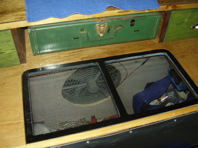

Just a thought. Could you be creating a negative pressure on the other side, which slows down the ability of the fan to pull air through the wall?

Thanks folks for the thoughts and advise,,, One thing I dont think is a problem is restricted air flow,,, the second pic is the intake in the galley,,, the area is almost double the area of the fan plus I had the a/c plug hole open also,,, and on the exhaust side ( fan pulls air from galley and blows on my feet) the door was open and a window,,, dont even say I got big feet and blocking air flow,,, just ask my girlfriend or one of my ex's,, they will testify to dat :lol:
