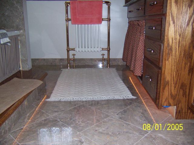

Here are some pics of what I did in my moms bathroom. The only thing I didn't do was to lay the marble. I had a friend who is a pro do it.
Andy
The bathroom was not done at this stage. The pics were to show the indirect light( mom did not want to turn on any bright lights in the middle of the night)

Great idea on that floor also like the radiator towel rack thing....I asked my better half about rope lights in the Tear and she just rolled her eyes at me......I think it would be cool

The radiator is hooked into the house boiler and warms towels and was a serious pain in the tushy cause she didn't decide on a new radiator until the floor and cabs were installed. I had to break up part of the floor to move the radiator pipes and then relay it. :(

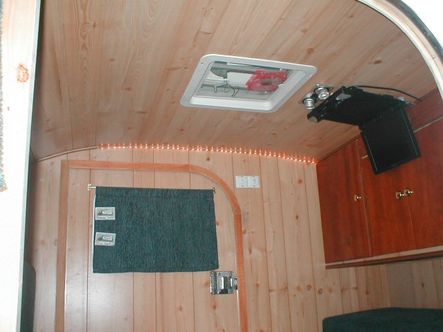

Postby JIML1943 » Fri Sep 15, 2006 8:01 am
I finally got around to taking pics of my rope lights.they give a nice glow to the tear, just enough light to keep from getting lost in the dark.
