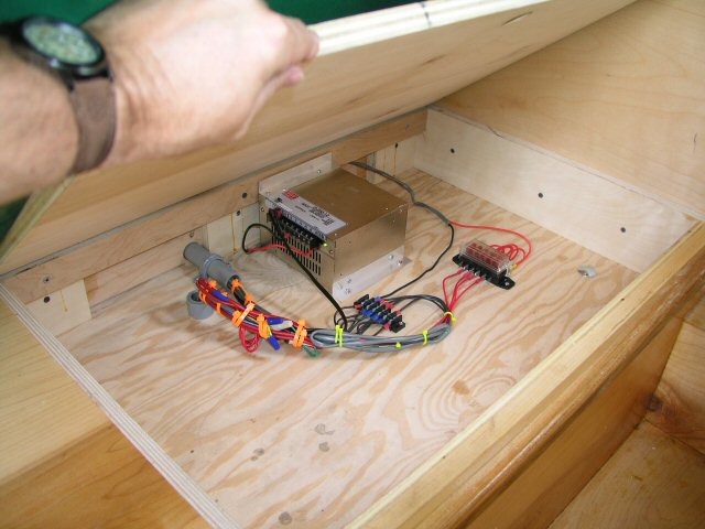

Postby mikeschn » Tue Sep 12, 2006 3:54 am
I've always wire for both... Some times I do it really simple, and other times, I'll do a fancy integrated job.
But most campgrounds here have electric available... but if you ever find yourself camping rustic, or on someones undeveloped lot, it sure helps to have a battery so you can have light.
My systems typically have an ac inlet, a breaker box, a gfci, and a 12v power supply and/or a 12v battery.
Mike
