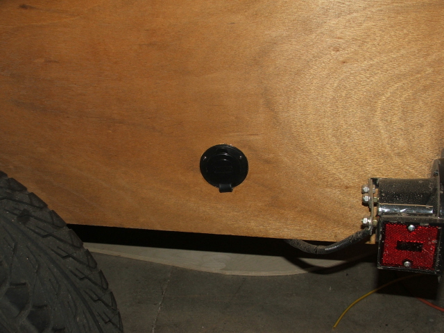

Postby Tripmaker » Fri Dec 15, 2006 11:03 am
I'm simply using a plastic power hatch available from any RV dealer for less than $5.00 This allows you to have an extension cord inside the camper. The hatch holds the male end so all you need to do is pull it out. The plug and wire that is. You can then close the hatch and there is a sliding door that is large enough for the wire. Clear as mud? I'll try to get a picture.
Jim

Postby asianflava » Fri Dec 15, 2006 4:50 pm
I have the same outlet cover that bledsoe has. Mine is strictly a cover that I run an extension cord out of. One time I forgot my extension cord so I just parked the trailer close to the pole.

Postby Tripmaker » Mon Dec 18, 2006 9:21 am
Tripmaker wrote:I'm simply using a plastic power hatch available from any RV dealer for less than $5.00 This allows you to have an extension cord inside the camper. The hatch holds the male end so all you need to do is pull it out. The plug and wire that is. You can then close the hatch and there is a sliding door that is large enough for the wire. Clear as mud? I'll try to get a picture.
Here is what I was talking about. http://www.rvsurplussalvage.com/catalog ... ct_id=4225
Simple and cheap unless you want or need 30 Amp service.
