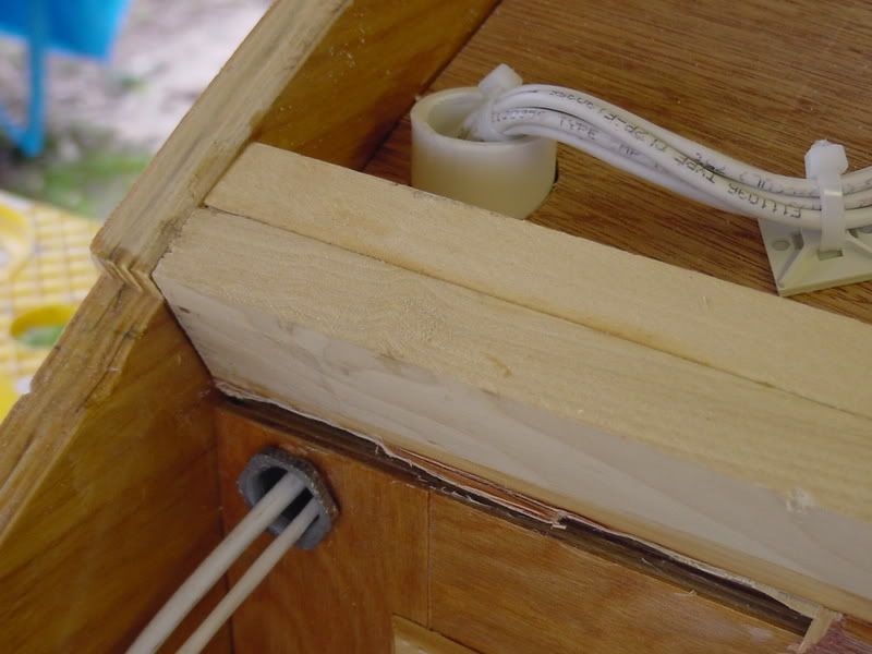

Okay, I have this idea about having a wiring connector mounted to the top inside of the hatch with all the wiring that is in the hatch i.e. stop/turn signals license plate light, power to hatch lights and 2 speakers. The plug to it would be on a pigtail coming from the galley cabinet face.
Here.....
I want a connector that MOUNTS so that it is ridged...like a plug on the back of the computer...but for bigger wire. Anyone know what male/female connector I can use?
Thanks
Mk

...we did the same...used a 6pin square connector...about an inch across each side...worked wonderfully well and should be available at most anypace that sells electrical goodies.....

...sorry don't havva pic or it would have already been posted...what I used is very similar to what MK shows...picked it up, prewired from either Auto Zone or a local camper supply sales place...don't remember which....the wire came out of the wiring chase...encased inna loom...to the connector...the other side...inna loom...went to a hole in the side of a hatch rib and into the wire chase on the hatch...worked great, allowing the hatch to be easily removed by unplugging the harness......

Mary, I don't know if this is what your after but it worked for me. I bought two 4 pin trailer pigtails in the 6 foot length at Walmart, one male, one female. I used one to connect to the 4 wires for lights on my 7 pin wiring harness and used the other one to wire the hatch for lights. After the hatch was installed it was a simple matter of plugging the two together. I wrapped the wires with automotive electrical tape to protect the wires. Worked like a charm. :D Danny
