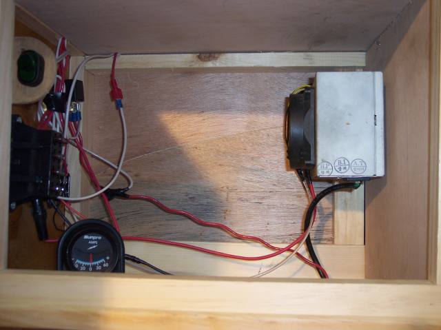

Postby myjeepcherokee » Sun Dec 26, 2004 4:09 pm
I too modified a pc power supply for my tear, but instead of using resistors to put a load on the power supply, I instead used the bulb in my amp meter to put a constant load on the supply. It puts out 10amps at 12 volts. I used it this past weekend for over 20hrs and no problem with heat or anything!

Postby myjeepcherokee » Mon Dec 27, 2004 5:53 pm
I feel pretty safe using my light bulb to supply a load on the power supply. I have my power supply on a switch and only use it when I need to be running off of shore power so I will rarely not have a load one the supply when it is on. I just view the bulb as extra assurance that if I for some reason dont have a load on it that it will be ok.
