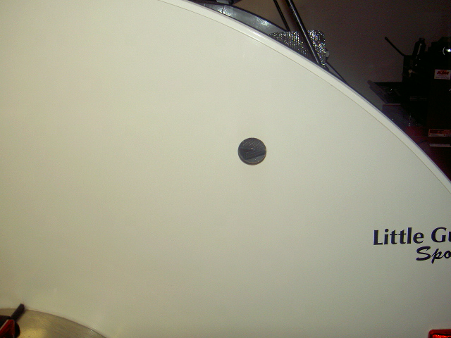

Here's a pic of the outer wall right after I bored through it with the holesaw. I did halfway from the inside and the other half from the outside and I got very minimal splintering of the wood and fiberglass covering.

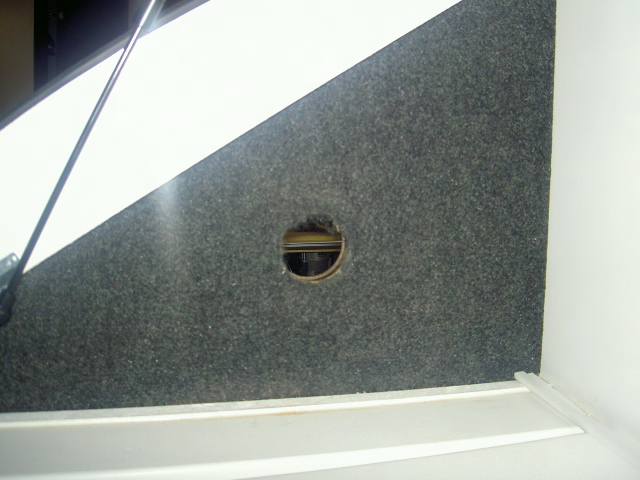

Here's a shot from the inside in the galley area showing the cutout for the Shore Power Inlet.

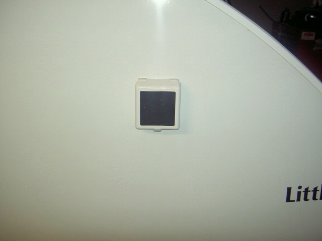

The inlet has been lined up and screwed into place temporarily.

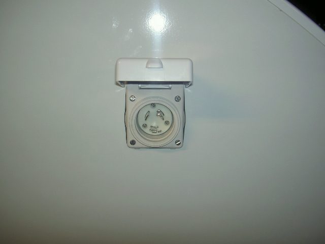

The Hubbell Shore Power Inlet with the hatch open showing the 3 prong 30amp plug. The extension cord will screw onto this making a watertight seal.

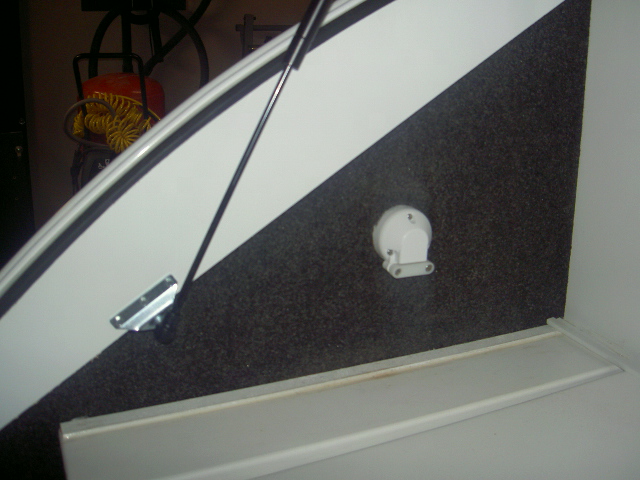

Here's the back side of the inlet with the cord strain relief temporarily installed.
Not too bad for a first time modification on the Little Guy.
