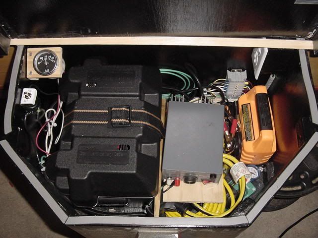

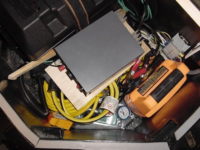

Here is whats in mine.
The Black Box is the Battery (of course), Its a Freebie car battery, used once. It doesn't hold a charge worth a poop, but it worked testing all the lights. See Voltmeter...
The Gray box is another Freebie, a 12vdc Power Supply, 4-6 amps. I will use it until I can afford the 5a Power Tender. The switch will switch between the Battery and P/S.
The Orange Box is a El-cheapo charger for HF, 1.5 Amp. Again it will be replaced in time.
The Terminals are for the Trailer Light wiring. Every wire (pos & neg) comes back to here, so if I have a problem, it "should" be easy to find.
I have my Circuit Breaker Power cords, Tire Gage (goes up to 60psi), 30amp to 15amp plug adapter, circuit tester and Shore Power 115VAC Outlet to plug in the P/S and Charger.
I have ta fix the weather stripping...I shouldn't have stretched it when i put it on....silly me.
Just thought I would share this with Y'all.

I have lots of 'stuff' in my tongue box. Sides for the ezups, stove, side change room, water hose, extension cord, stakes, hatchet, folding chairs, and a few other things.
Looks like you did a fine job fitting all that into the tongue box!! Does the P/S slide around in transit (doesn't look like it is fastened down)?

Thanks Kerry. You must have a Big Box, thats a lot of stuff... :shock:
The P/S is loose. It gets kind of warm , so I place it on the board you see in the pic and then on top of the battery and I keep the lid open on the box to help circulate air. I will secure it when in transit.
