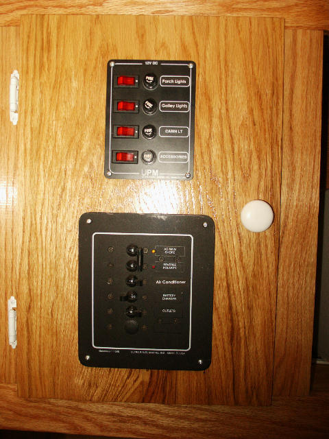

Postby Miriam C. » Mon Apr 07, 2008 6:05 pm
Mary K wrote:Did Y'all just want the AC, or do you want DC wiring too?
DC is good too. I know you have great pictures of everything. :thumbsup: Thank you. :)

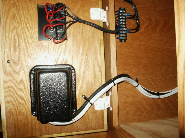

Postby Miriam C. » Wed May 21, 2008 2:36 pm
KISS my DC panel. 8)
First I got a marine panel from Bass Pro Shop. The panel comes pre-wired and I left most of it alone.
Then went to Radio Shack to get something for a grounding block. Got a Barrier strip and a Jumper strip. I had to cut the jumper strip in half. 8)
Off to wire it up. The very first thing I did was get rid of the small "disconnects" for the incoming power and ground. Added 10 awg wire for both. Wired my hot wire (black) to the light fixture and the white ground to the negative terminal block.
Some of this is easier done before the panel is up if you don't have a lot of room. Now I know some don't like wire nuts but I might change the light and want it to come off. I also put wire nuts on the unused wires so they will keep from contact and be there when I need them.
Next is to screw it down and hook it up. 8)
The black wire with the yellow wire nut is 10awg and goes from the negative post on the panel to the negative terminal and the second one goes to the negative post on the battery. The red goes straight to the battery. I will add the battery disconnect as soon as I get some blocking in for it.
The 12 volt reading lights that get a new position as soon as I get to it.
Enjoy wiring your TD. It is a learning experience and you don't need to get fancy.
