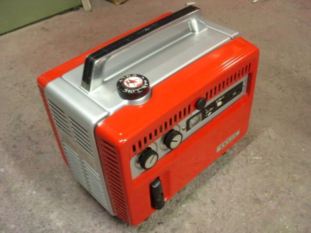

I bought 4 WV chargers off Ebay, removed the inline limiter/diode and wired them all together and mounted them on a tripod. I bought a solar controller off Ebay and hook them into the tear with a 1/4 plug in connector
it puts out 20 watts at 18 volts and keeps my battery charged very well.
On my last trip I ran my XM radio all day, My grand daughter watched a couple movies every night on my TV/DVD, ran lights all night,water pump, fan. Pretty much used tons of juice and after 4 days the battery was still fully charged. I think this setup would keep me in electricity full time as long as there is sun. I think the entire setup cost me less than $100. I have a very small Honda generator that I rebuilt and haven't had to use it once. Here's a pic of what I have, Aaron
