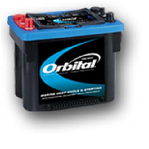

Postby boomboomtulum » Fri Jan 18, 2008 8:07 pm
This is the Battery I purchased, photo is a little fuzzy but it's made by Exide, I have run lights during construction now for 20-25 hrs. and have yet to plug in the convertor to charge it. I'll find the specs. and post those as well. Dave
http://www.exide.com/products/marine_rv ... cycle.html
http://www.mikenchell.com/forums/album_ ... c_id=37109
