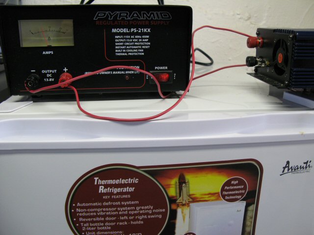

After our dismal failure with our thermoelectric refrigerator a couple years ago, I resigned it to the basement to keep our beer cold. It works great for that.
However, rustic camping has me thinking about it again. What would it take to make it work? So I went downstairs and threw it on the inverter with a power supply. The power supply tells me it's drawing 6 amps, 24 hours a day.
That's 144 amps per day, or for a typical weekend, 288 amps. If I don't want to draw the batteries down more than halfway, I would need 5 huge deep cycle batteries for 2 days of refrigeration.

mikeschn wrote:...The power supply tells me it's drawing 6 amps, 24 hours a day.
That's 144 amps per day, or for a typical weekend, 288 amps. If I don't want to draw the batteries down more than halfway, I would need 5 huge deep cycle batteries for 2 days of refrigeration...
Mike, I'm not trying to be picky, but people keep getting confused about this, partially because other people are not clear in their use of units of measurement...
6 amps for 24 hours is indeed 144, but it's amp-hours. An amount of charge is not the same as a rate of current flow, and mislabeling the first as just "amps" really throws some people in these discussions.
The weekend takes 288 amp-hours, which would be over 56 amp-hours for each of 5 batteries, which I agree would be about half of the capacity (and thus a reasonable level of discharge) of relatively big (group 27) batteries with a capacity of around 100 amp-hours each.

You could use watts. Six amps at 12 volts is 72 watts, about the same as a fair sized incadescent bulb, or a fluuorescent fixture with two 4 foot tubes, Figuting it runs all the time that is a good bit of power, more than my 60 watts of solar collectors put out at peak.
I too bought on of those Coleman peltier coolers and besides the power problem, they have a limited cooling capacity---no more than 40 DegF difference so if it;s 90 degrees outside, they only keep your beer at 50 DegF. And if it is dooler than 60 DegF, the beer can freeze. They're great for running vehicles, but if left for more than a few hours without the engine running you better be parked on a steep hill.

Whether the power consumed is measured in watts, or just the current is measured in amps, the problem with the thermoelectric cooler is not really just the power they take, but the fact that they seem to need it almost continuously. The compressor-type units might take about the same current (and thus the same power) when they're running, but that produces more cooling so they don't need to run nearly all of the time... unlike the thermoelectric unit which Mike tested.
That's where the amp-hours come in... amps times hours is the battery capacity consumed, and that's the critical factor in making through the weekend. Whether it's 6 amps (72 watts) all the time, or 12 amps only on half the time (144 watts peak, 72 watts average), it's the same total charge used.
