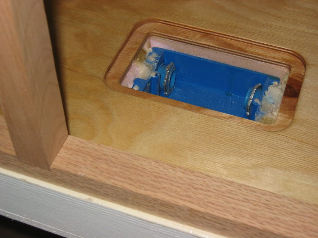

Postby Woodbutcher » Thu Feb 21, 2008 8:45 pm
I ran plastic conduit sandwiched in my floor . The box in the front comes under my headboard. The middle boxes have a wooden cover near the door. I went up into my wall from there. The boxes in the rear are in the galley floor. I am able to pull out or add wires to most everywhere except the ceiling. The running lights in the rear are the only wires under the floor. Only about a foot of those show. Had I planned it better I could have hidden them as well. The front running lights are drilled through the body into the headboard area box. It's a little more work and some extra weight but I have a lot of flexability.
Here is the middle box with the cover.

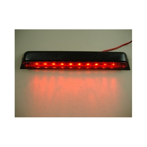

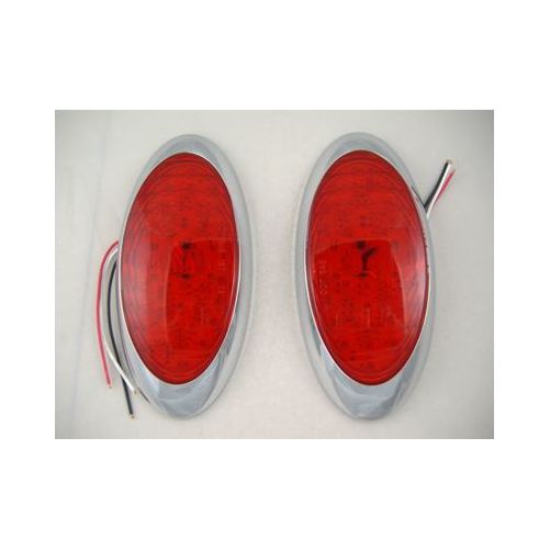

Postby looped » Sun Apr 20, 2008 5:55 pm
i plan to run these in red and amber on mine for the sides
oops nix those found some that match better.
and these on the rear mounted in the galley door
and one of these on top
just hoping this isnt too much overkill

Postby brian_bp » Mon Apr 21, 2008 5:12 pm
looped wrote:i plan to run these...
...and one of these on top
Is the one on top intended as a Center High-Mounted Stop Lamp (CHMSL third brake light)? If the trailer has combined stop/turn lamps (not separate turn signals), then a central brake light will need a converter circuit to run it properly, so it doesn't flash with the turn signals.
I don't think a CHMSL is overkill at all... people expect them now, so a vehicle without is less noticeable when it brakes.
