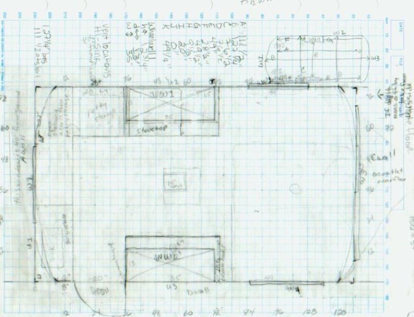

Here's my current floorplan.
I'm considering 3 undercabinet lights along the back end (left of the door) of the trailer. The wheelwell opposite the door will be where we put the stove. I'm definitely interested in overhead lighting there. The front of the trailer (the big, blank - still unplanned space) will have the seating / gaucho bed / dinette / berth & should have lighting there. The wheelwell to the right of the door will have the 100qt cooler & some under cabinet lighting.

Thanks for dropping by brian. I was looking at the 15W (825 lumens - 18"x4"x1.42"?) until I found the Thinlite recessed which had 1650 lumens(cutout 19.25"x5.25"x1"). While I'm not sure if this is a technically accurate way to look at lighting I began looking at lumens per amp (or lumens / watt) as the beginning of my little cost/benefit analysis.
