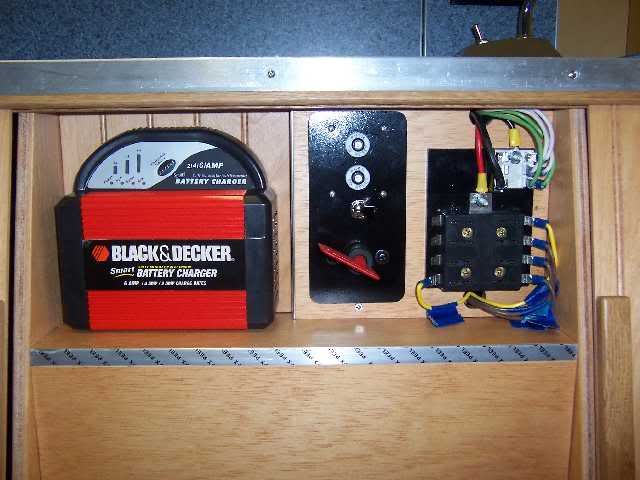

Postby madjack » Sun Jul 06, 2008 1:35 pm
Reddiver wrote:Mad jack thanks I new somebody made a compact circuit breaker . I just sent for the catalog
keep in mind that these are a panel mount unit and you will havvta make up your own panel/box....we use a scrap piece of formica for this...in the pic below, you can see them in the center portion as 2 "buttons"...
