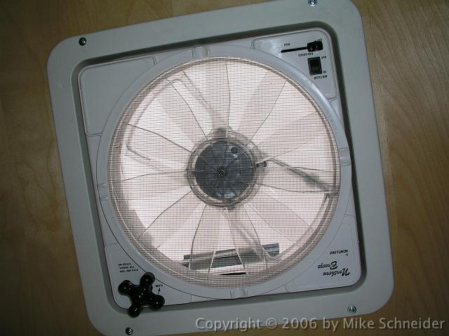

Postby mikeschn » Fri Aug 22, 2008 4:21 pm
The Northern Breeze has a slide control on it, and one can get it running nice and slow.
Of course, I don't have a Northern Breeze handy right now. I just swiped the fantastic fan out of the Escape Hatch, and if you guys can tell me how to slow it down, I'll use it, other wise, I'll be looking for another Northern Breeze.
