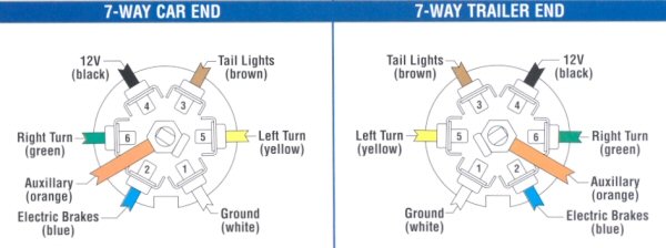

I've got a question for you electrical experts.
When I had the passat hitch installed, I had them wire in a charge line. Looking at it now, it's nothing more than a black wire from the battery to pin 4 of the 7 way plug.
Oh yes, supposedly there is a fuse somewhere in that line too!
Is that right? I thought the line was supposed to come from the alternator, not the battery. Is that puny little line from the battery enough to charge the battery in the teardrop when I am towing it?
Your thoughts?
