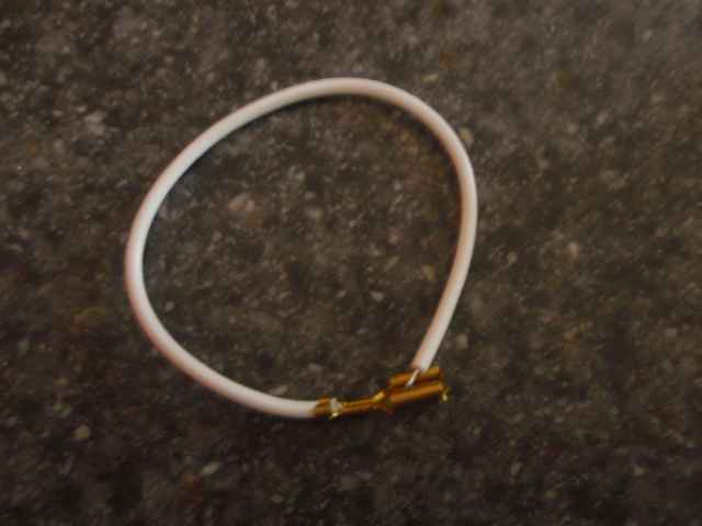

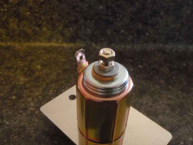

I ordered a few 12v receptacles the other day and they came in today. i am really confused, or maybe i just dont understand how 12v receptacles are are wired. This is what the unit came to me looking like:
It also came with a white wire with a spade plug and an exposed end.
What in the world is the white they sent me? for ground? there is a little loop sticking up on a blade that looks like it would be for a ground. can someone help me out? did i order the wrong thing?

Postby Dale M. » Sat Oct 11, 2008 12:04 pm
NO you probably did not order wrong thing....
Typically a cigarette lighter/accessory socket is wired with +12 volt wired to center stud/nut .... The white wire (jumper) is to connect the ground side of socket (shell) to any sheet metal in structure or chassis that is grounded to battery if chassis is use as ground conductor and/or socket is mounted in plastic or some other insulator....
IF you are unsure of mounting surface (grounded-not grounded) just run a "ground" wire (- negative side of battery) to the "push-on" blade terminal on "shell" of socket....
Dale

Postby rhltechie » Sat Oct 11, 2008 12:39 pm
ok...thanks for that. thats what i was thinking but i was really confused that they had sent me a white ground wire. so basically i just run my positive to the nut portion and my ground to the spade/blade deal.
makes perfect sense..NOW :)
