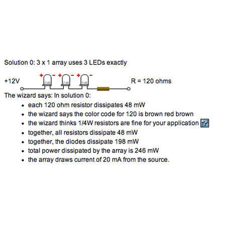

I used this LED calculator to figure out what resistors I needed to use, and how to wire it up. You need to use a resistor to avoid burning out the LED.
http://led.linear1.org/led.wiz
Here is the diagram I used for 3 LEDs and a 12v power source.

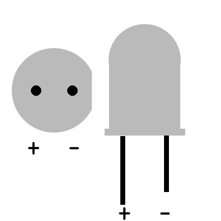

On an LED, there is a bulb or diode with 2 wire legs on the bottom. One leg is positive, and one is negative. Usually the shorter leg is negative, but you can also see that looking at an LED from the top or bottom, one side is cut off, and it is not a full circle. The side that is cut off is the negative.

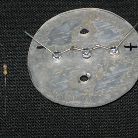

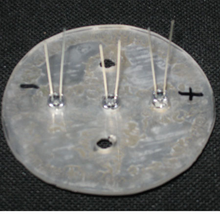

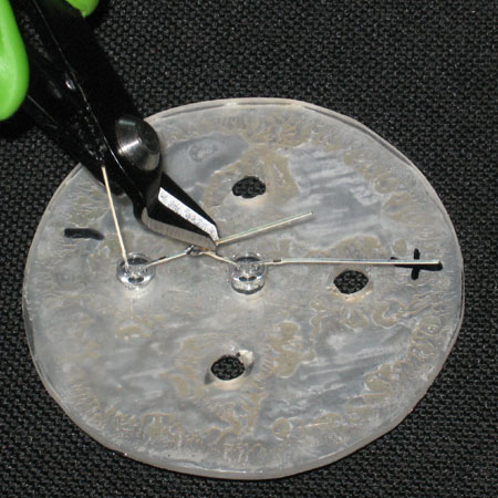

I then laid out the LEDs in the disc I made for them. I marked the positive and negative sides on the disc. I arranged these like this in the picture as a demo. I did not arrange the lights straight across like this on my actual puck lights. I clustered them together to keep the wiring less confusing.
Solder the LEDs together. Positive to Negative leaving a positive leg and a negative leg available at opposite ends of the chain. Then, clip off the excess.
You can see the resistor to the left in the picture. Wire the resistor to the free negative leg. Then you can attach the Negative leg to the Negative post on the battery. I know this is wired for 12v, but for the picture, I used a 9v.

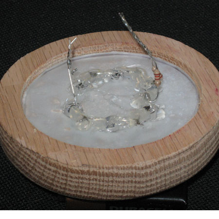

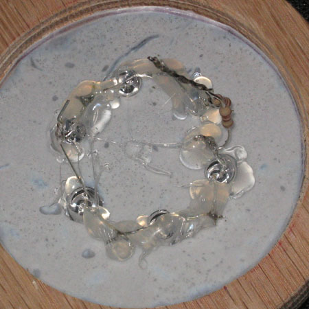

I used a glue gun to cover the bare LED legs so that they would hold the LEDs in place, and avoid shorting each other out.
From this angle, you can see the Positive and Negative leads. The Negative lead is the one with the resistors.

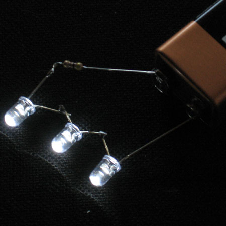

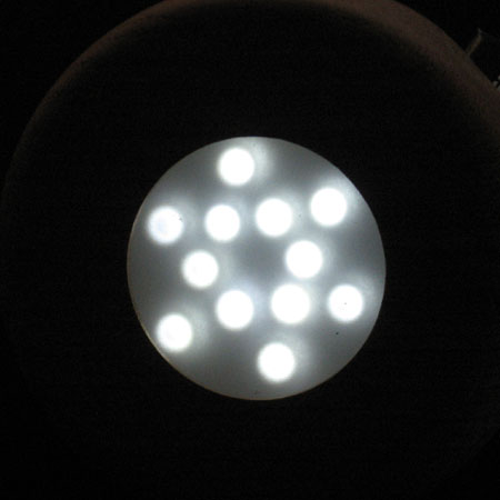

And last, here it is hooked up to a battery, mounted in the housing and lit up. The picture does not do the brightness of it justice.

Postby brian_bp » Wed Nov 12, 2008 2:26 pm
Don, very nicely done, :thumbsup:
and thanks for the exceptionally clear description! :applause:
Do you think the LED leads or resistor will get warm enough in use to cause any concern with the hot glue material melting? I'd guess not, I'm just wondering if this had been considered.

Postby jss06 » Wed Nov 12, 2008 3:08 pm
brian_bp wrote:Do you think the LED leads or resistor will get warm enough in use to cause any concern with the hot glue material melting? I'd guess not, I'm just wondering if this had been considered.
The heat produced will not even be close to the melting temp of the hot glue.

Postby donmaloney » Wed Nov 12, 2008 3:24 pm
That is some great work. Makes me wish I had a lathe.
I very rarely use my lathe, but I love it when I do.
I had thought about the heating of glue, but I did not imagine the lights would get too hot. (Make sure you are done soldering before using the glue, though!!!)
The reason I used the hot glue is in case a bulb burned out which is rare, but not unheard of. I figured it would be easier to pull off the glue, replace the bulb, and glue it up again. I would hate to have an LED burn out and have to rebuild everything.

Postby brian_bp » Thu Nov 13, 2008 8:45 pm
donmaloney wrote:I had thought about the heating of glue, but I did not imagine the lights would get too hot. (Make sure you are done soldering before using the glue, though!!!)
The choice of hot glue does makes sense to me, and it certainly would be easier to peel it back than trying to break leads out of the epoxy which might otherwise be used!
