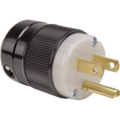

This is the 20 amp Marinco Inlet :
I'll drill a 1 7/8 hole in the side of the tear drop to install the inlet. The problem with the inlet is that it is 20 amps and because of this, the male prongs are aligned perpendicular to each other, not parallel like a 15 amp setup.
I need an adapter to convert 20amp to 15amp. I'm not having much luck finding such a thing.

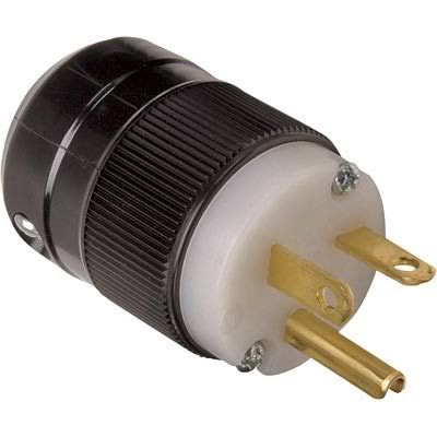

Postby Gerdo » Tue Apr 28, 2009 11:04 pm
A 15 amp plug has a ground pin and two blades that are parallel to each other.
A true 20 amp plug has a ground pin, a neutral blade that is the same as the blades on a 15 amp and a hot that is turned 90*.
Is this what the plug looks like?
It sounds like you need to make a short adapter. You need a 20 amp female connector, a couple of feet of 12-3 wire, and a 15 amp male plug.
OR you can cut the end off your extension and hard wire on a 20 amp female connector. This is a simple fix and the way I would deal with the issue.
20 amp connectors will accept either a 15 amp or 20 amp plug. It should look like this.

Postby Uncle Chan » Tue Apr 28, 2009 11:05 pm
Thanks all. Looks like I'll be making my own.
Gerdo, the second pic is what the inside of the inlet looks like. Gerdo and Kevin, I like the idea of cutting the end off of the HD cord and just putting the 20amp female on it.
