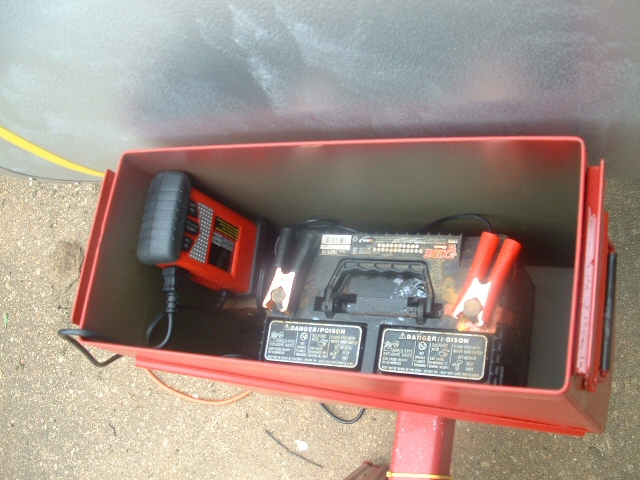

Mainly due to the smaller size of Itty-Bitty, my original intention was just to carry the battery in the the TV, set it on the ground and hook it up with alligator clamps when I got to where I was going. Throw it on the charger when I got back home.
Plans changed!!!

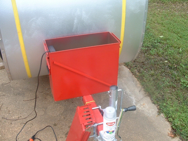

I scored a battery tender at a yard sale for a dollar and three (3) free batteries. Now I had to come up with a plan. It's not complete; but I managed to figure out a way to get it included keeping everything in proportion to the tear. I have to hard wire an outlet into the box for 110 to power the charger and tie it into the 110V system, add a battery disconnect and make the connections to the 12V system on the tear; but this is where I'm at. I did see some soffit louvers at Lowe's this morning that I think I can cut into the side of the ammo can to provide ventilation and still remain relatively water resistant.
To the topic at hand, there is no doubt in my mind that I WILL ventilate the box. Now I just have to find someplace else for everything that was originally going to go in the box!!

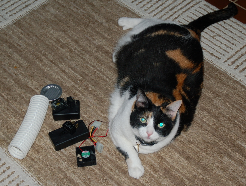

My new fan is only 50 mm, about 2", but it moves almost 20 cubic feet per minute. 12V and I am setting it up to run only when there is AC power to the converter. A thermostat mentioned earlier may also be good, but I do not want to use battery power for this fan if the converter is unpowered. A switch could also turn it off, but then one has to remember to do that. These are some of the parts I have assembled but not yet installed.
Paige is always ready to inspect trailer parts and help with photos. The relay coil is 120V AC and will turn on 12V DC to the fan. A toggle switch will turn off power to the relay coil if the fan is making too much noise for sleeping. So far I have only powered the fan to test it and it seems very quiet.
