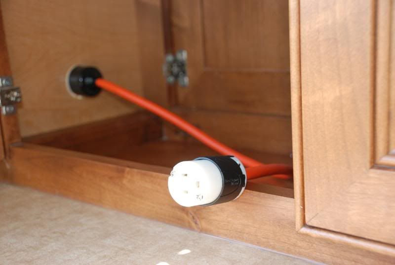

This is what things look like so far with the 20amp setup. Now, mind you, I went through the cabinet. When I put in my 30amp system, I'll go through the galley, left most part.
This is the 20amp inlet from Marnico:
The next three pics are of it installed:
From inside the galley:
Female 20amp plug where the 15amp powerstrip will plug in

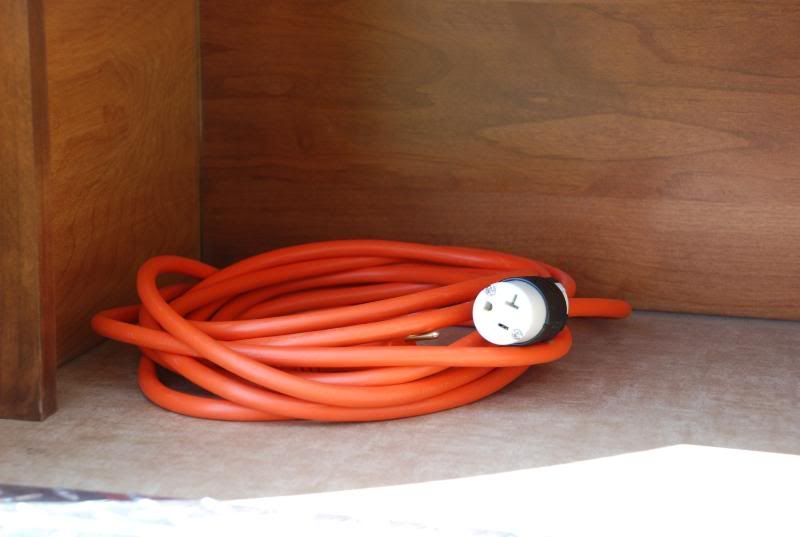

12ga extension cord with 20amp female to mate with the 20amp Marinco Inlet pictured above:
I forgot to take one of the extension cord plugged-in, but I think you got it. I was concerned that the cord would pop off of the inlet, but it is on there pretty good.

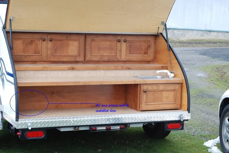

Here is a pic that shows where I'll install the 30amp system:

Postby dreadcptflint » Mon May 11, 2009 12:56 pm
Good placement. I can see that you can take power into the cabin or back in the kitchen. The white plug blends in well.
