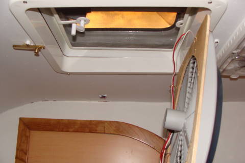

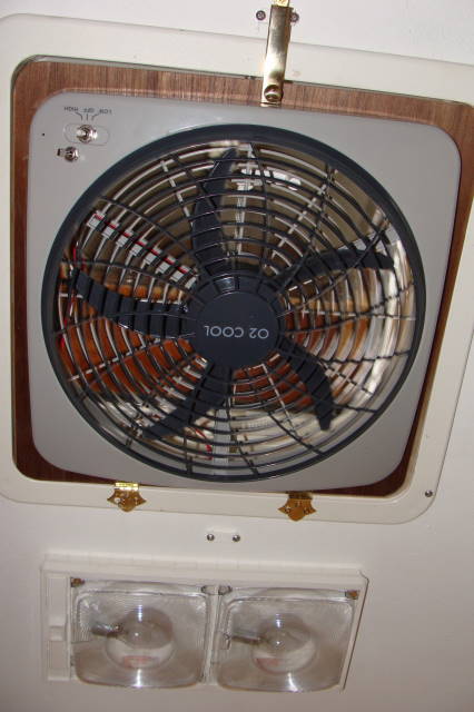

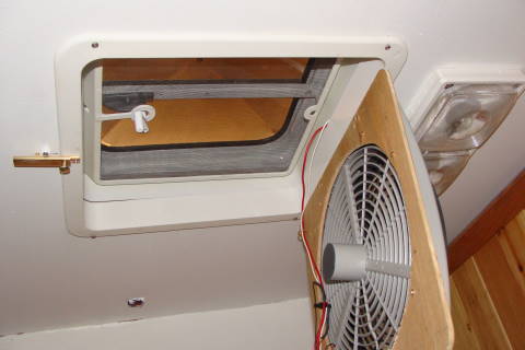

I bought an O2 fan at Walmart for $13.00. I then went to Radio Shack got a couple of switch's. I now have a vent fan for less than $20.00 that work great. The fan reverse's and goes forward, has a high and a low speed and is hooked into the trailer battery. Pics in my album. Jim G

...nice job :thumbsup: :thumbsup: ...how/what did you do to deal with crank to open the vent????????

Postby Kevin A » Sun Jun 07, 2009 1:45 pm
Jack,
It appears that he mounted the fan assembly with hinges and some sort of latch so he can drop the fan to access the vent.

That really is O 2 cool! 8) couple of ??'s: Why the new switches, I'm assuming that the original location is not accessible when mounted.
Did you find it in the automotive dept (since it's 12v)? Good work :thumbsup:

Postby MOKI SEAKER » Sun Jun 07, 2009 3:27 pm
It didn't have a switch for reverse so I installed one. I got the fan in the sporting goods section at Wal mart. It would normally run on 8 "D" batteries I think that is 12volts so I threw away the stand which is the battery holder, I didn't care for the original switch so I changed it also $3.24 at Radio shack. The fan swings down to allow access to the vent crank. Jim G. :D

Postby madjack » Mon Jun 08, 2009 1:39 am
Kevin A wrote:Jack,
...yeah, I saw the hinge/latch setup BUT, all the vents(w/screens) I have seen had a crank sticking down into the cabin, the crank was located just off center and would interfere with a tight-against-the-opening fit and would have required removal of the crank to fit the fan............

Postby MOKI SEAKER » Mon Jun 08, 2009 2:36 pm
Your right I didn't include enough pics. There was enough room for the crank and motor. You darn sure need screens down in your part of the world, I think the skeeter mate with the gators. Jim G
