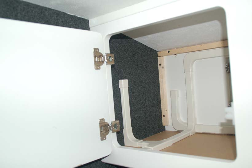

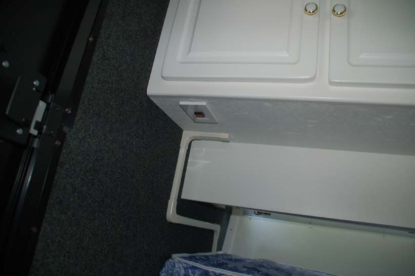

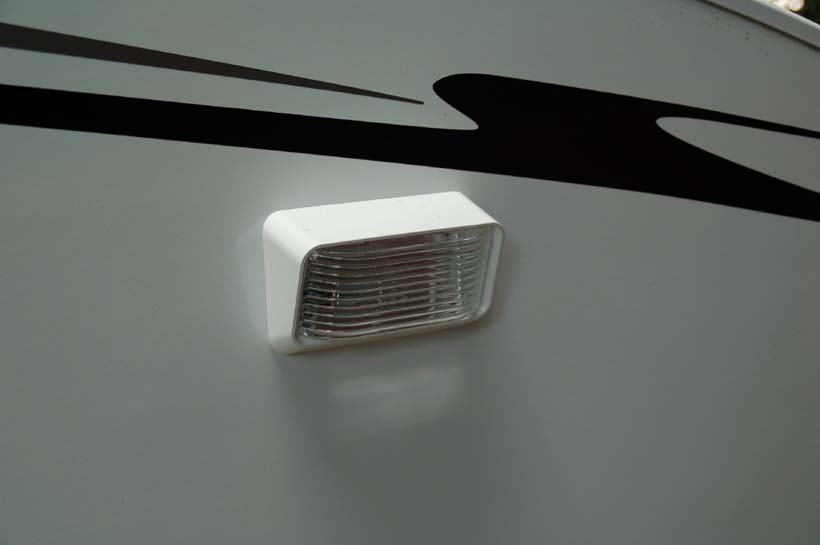

We went with a light on each side and a switch on each side just inside the doors. We can easily reach the switches from inside or outside, although we need to open the trailer door to turn a light on or off from outside the trailer. I did not think we needed to control both lights with either switch so they turn on or off individually. The lights we have are available with or without a switch on the housing. We got the ones with no switch to use as porch lights. In the galley we use the same lights with a built-in switch. The first photo shows one of our porch light switches (Radio Shack). The face plates are standard ones from Home Depot with a blank insert. A round hole is drilled in the insert for mounting the switch, a simple on-off arrangement.
Image\
Next is a photo of the wiring. The light is just outside the vertical raceway on the trailer wall. The shorter vertical raceway contains wires for one of the galley lights.
This is a shot of one of the lights.
