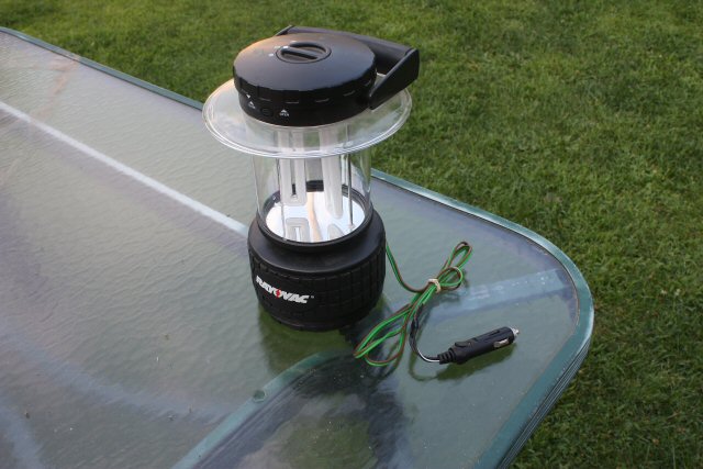

The original plan was to use our battery powered lanterns which we have modified by adding a plug to it.

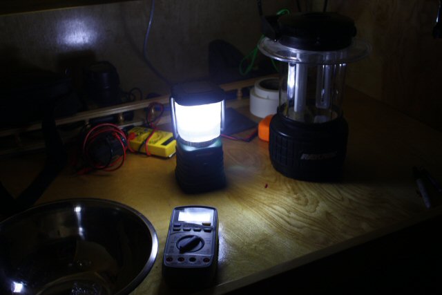

BTW, I check the lantern in the first pic, and it draws 1/2 amp. I checked the outside porch light, after I put in the superbright led, and it appears to draw just about nothing!!!

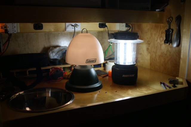

This one might have possibilities. It comes with a plug that I can plug into a 12 volt outlet. But how bright is 145 lumens???
http://www.coleman.com/coleman/colemanc ... 2000001562

Just for fun, I took my light meter outside, and measured the Lux from these two light sources...
The Rayovac has a lux of 1800 at a distance of 4"
The Coleman lamp has a lux of 40 at 4".
Hmmmm... better convert that into lumens...
1800 lux = 167 lumens
40 lux = 4 lumens...
That makes the lantern with 145 lumens pretty bright!!! :thumbsup:

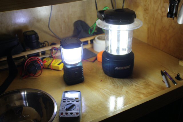

I went out this morning and picked up the Rayovac Sportsman that's supposed to get 300 lumens.
Here's what it looks like...
It looked bright, but not THAT bright. So I went and got out my light meter. Hmmm it measures 500 lux at 4". Um... that would be 46 lumens.
Notice too, in the picture, that the light does not light up the surrounding walls very well. It was pretty dim in the trailer with just the Rayovac Sportsman turned on.
Okay, lets turn on that old standby, the Rayovac 8D Fluorescent Lantern. Wow, what a difference. Look how it lights up the interior walls of the trailer.
I guess I am done looking for now. I'll stick with with the Rayovac 8D Fluorescent Lantern.

Postby ARKPAT » Sun Aug 16, 2009 9:08 pm
Looks like the LED vs the tube lights are ( LED = TASK Lighting and Tube lights = AREA Lighting ). Good comparison Mike. :thumbsup:
