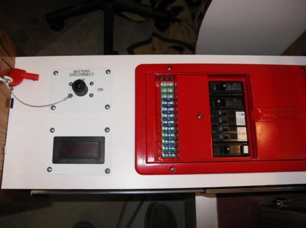

My battery and charger are in the tongue box and the fuse panel is in a slide out in the galley. The battery adds a little weight to the tongue but I didn't want it in the tear. I used a blue top Optima battery and a Deltran Battery Tender. So far the arrangement is working great.
