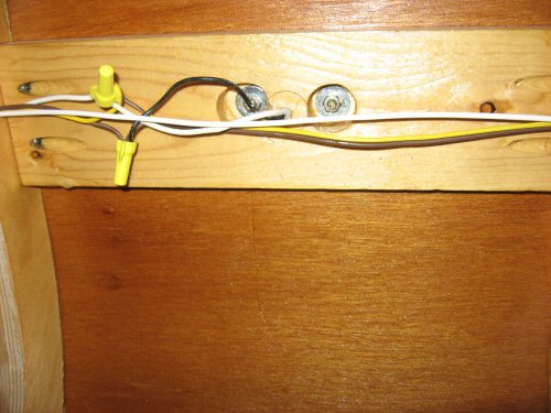

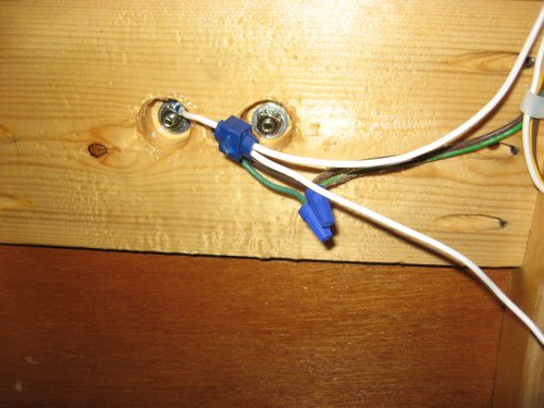

Sorry I am late to the party. Do you have pictures of the back of the lights? My lights didn't have a ground and they are seated in wood. No metal for a contact ground. This is my solution.
Tag light. I have ring connectors on the posts.
Left tail light detail.
The wiring goes to a ground screw on the trailer frame. Works well.

You can put grounding blocks on your frame. If you look under they might actually be there. You do need to clean them up every now and again. I just unscrew and clean the way I would a battery. :thumbsup:
