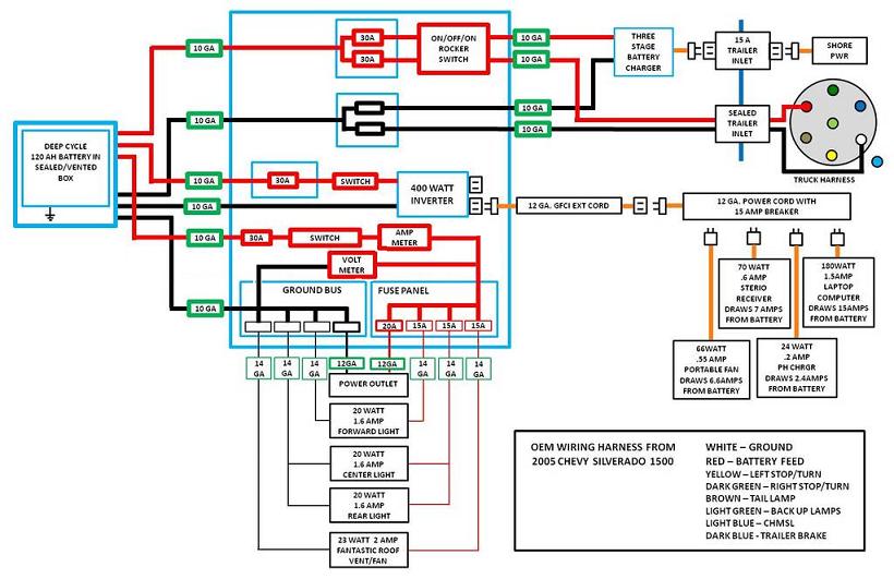

As a relative novice to wiring, :? I've used the dissussions here to put together a proposed plan for my CT conversion. I'm sure there are some things that need adjusting so I'm looking for some guidance (which is much appreciated!) :bowdown:

Only issues I see is VOLTMETER..... It would appear you are running the voltage through it as same as same as ammeter..... A VOLT meter is wired across (bridging) the 12 volt line and ground..... Technically nothing goes through it....
The above sketch is for a "automotive' (engine) application but the same "concepts" of wiring apply to your voltmeter circuit... Also you may want to put a push button or toggle switch in volt meter circuit so its not live all the time, although the "drain" from meter is minute, over a long time with trailer just sitting it will drain battery if trailer is not hooked to shore power and charger operational. And the is no need for it to be live when nobody is looking at it...
Also it appears that you have unlabeled fuses in ground circuit between "external power" and battery ... Schematic does not need this representation.....
Also for clarity, you may want to show "master buss bars" for 12 volts and ground, with fuses directly off them instead of taking the 3 battery(12volt) /ground circuits into battery box.... It really does not matter, because electrically its all the same......
Also a little magic with a relay could replace the rocker switch from manual control of battery charger (shore power) and TV charging.... But then again you may not want that feature automated...
Incidentally the Chev uses a 40 AMP fuse on the line going from fuse in engine compartment to trailer connector....

As Dale said about some mods would make things automatic on plugging into shore power for charging the battery and inverter override ( depending on charger size rating ). Here below is a PAINT redraw of your circuit with the Volt Meter in the correct place.

Thank you for the replies. I understand how the voltmeter should be wired now. I'll make these changes as noted though I'm not sure I want to get into relays untill I've got the rest sorted in my head.. :crazy:
I have an additional question or two.. Let's take the charging ciruits out of the equasion for the time being and assume that for a 30A circuit a 10ga wire is needed.
After reviewing the power drawn from the inverter (if everything was in use) it adds up to 31A, so would I need an 8ga/50A wire/fuse in that circuit?
The wiring shown in the 4 bank fuse panel has power to an outlet, three lights and a Fantastic fan. The fuse #'s add up to 65A, but realistically it would be more like 20A for the power outlet, (using the max because this is a variable) and 6.8 for the lights and fan, for a total of 26.8A. At this time, this goes into one 10 ga/30A wire/fuse.
Assuming an 8ga/50A wire/fuse carrying 31A from the inverter to the master buss bars, and 26.8A from the power outlet, lights and fan to the master buss bars. If everyting was on at once, (a total of 57.8A) which probable won't happen though I want to play it safe, I'm not sure how to determine the size of the wire/master fuse that would go between the battery and the master buss bars.
It appears as though I would need a 60A master fuse using a 6ga wire from the battery to the master buss bars. Is this correct or do I have myself spun around?

Postby Dale M. » Sun Nov 22, 2009 10:55 am
New drawing looks pretty good....
Keep in mind advertises loads for devices are not always what unit actually draws. Usually they are less....
Keep in mind you will not be drawing maximum current to all devices all the time ....
As for wire gauge, except for main buss leads (battery to buss bars) you probably don't need anything larger than a 10 gauge...
According to this chart, you can draw up to 50 amps a distance of 20 feet on a 10 gauge wire....
Keep in mind you can end up with "heavier" wire (weight wise) and more expensive wire (gauge) that application requires...
Its ok to over engineer, in fact in my work world before retirement the saying was "when doubt, go next size larger".... But the are limits to that thinking also....

Thank you for the information, :applause: looks like I'm over engineering it a bit. :thinking: I'll redo the schematic, with wire length in mind (and a bit of a safety margin) using the chart as a guide.
Now, bringing the charging circuit back into play, is it ok to run that into the same fuse panel/ground bus as the other circuit? Would it be ok (and I think I read a thread on this subject but I don't remember..) to charge via either the TV or the battery charger while I'm drawing power from the battery?

Yes its ok to bring "charging circuits" to the buss bars (ground bar and fuse panel) shown on second sketches... Its just a common point where everything connects.... Its no different than taking charge leads direct to battery except it will go through the 60 amp fuse and amp meter..

Based upon what I see, you are planning on drawing over 30 amps from your battery for extended periods (more than a few minutes at a time). I don't have any numbers to support my thoughts but in general you can only draw down half of the capacity of a battery before you need to recharge it. So, you have two hours max battery life at your expected draw. Not much, again IMHO. Drawing 30 amps from a 120 amp battery is too much to sustain for long and you won't even get the "rule of thumb" 50% of capacity due to the heat generated. In addition, the inverter isn't 100% efficient and effeciency varies with load. Finally, drawing your battery down frequently will greatly reduce its service life.
Following the guidelines on the Schumacher site it will take a long time to replace the energy you expect to draw from your battery. So, you'll need a lot of power, somehow (via ac charger, tow vehicle, or solar panels), to recharge your battery. More complications.
Why use an inverter at all. Going through multiple voltage conversions is not efficient. Why not use a 12 volt power supply for your computer, a 12 volt fan, a portable radio with 12V input, and a 12 volt charger for your phone. 12 volt doodads are usually designed to use less power (yeah they're not as powerful as 120 volt doodads but they can get the job done).
The "trick" to running on battery power is to minimize loads. No need for a gazillion watt stereo for some light casual listening in a campground (after all do your neighbors want to listen to your choice of programming). Use a small DC powered radio. Do you really need a fan? I leave my cell phone plugged into my car most of the time I'm out and about and have never even dented the car battery. Don't go through multiple conversions for the computer.
If you have commercial AC available, use it directly without going through the battery and inverter. Saves wear and tear on the battery and inverter. If you don't have AC available, work to minimize your DC load.
In short, keep it simple and minimize load. Crusing sailors have learned that doing without AC is much easier in the long run when away from the dock. When at the dock, use the AC as it comes from the plug, not AC to DC, and then DC back to AC.

1. On the charging circuit... the on-off-on switch, I assume that this will be wired so that only one charging source is connected at a time, right?
2. Also on the charging circuit... you can tie the two together on the other side of the 30A fuse and save yourself a fuse.
3. The way you have the amp meter wired, it won't see the current going to the inverter. Also do you want to see charge current or just discharge current?
4. I would prefer to see one cable going to each battery post from terminal blocks... i.e. all the 10GA wires go to terminal blocks, then one 4GA cable (or whatever size is appropriate) from the teminal blocks to the battery terminals. Makes for easier troublshooting, and connecting and disconnecting the battery.
5. 30A * 12V = 360Watts, not enough for a 400W inverter.
