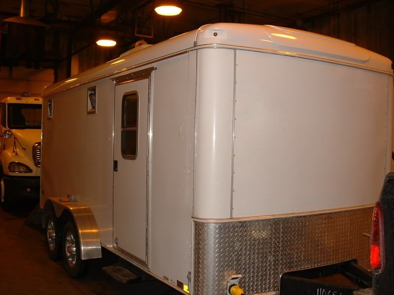

12v trailer lights only work when my key is on how do I change this. I have a 2008 Ford F350 any suggestions.

Probably a control relay issue..... It only allows the ACC /12 Volt prong in connector to be hot if key is on...
You may have to pull relay and put in a bypass (short jumper with two male push on connectors).....Or do a rewire of control lead for relay to dash mounted switch to over ride computer/ign key....
Or as someone else has mentioned run new lead from battery to connector that is "hot" all the time....

My owners guide says it ahs a relay for trailer tow battery charge so is there a wire fed to my 7 way already?
BirdDog1
Posts: 20
Joined: Tue Oct 06, 2009 3:14 pm
Postby Cliffmeister2000 » Tue Dec 29, 2009 4:10 pm
That's the one, but it's switched. Key must be in "RUN" position (as you have already discovered).
