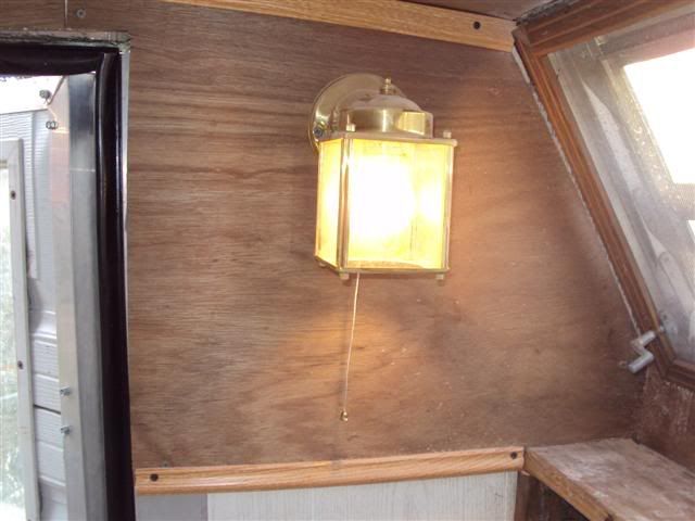

Postby eatatjoz » Tue Jan 26, 2010 11:38 pm
I used 110 fixtures with 12v bulbs and put ceiling fan pull chains in them.
It works out really well while lying in bed.
