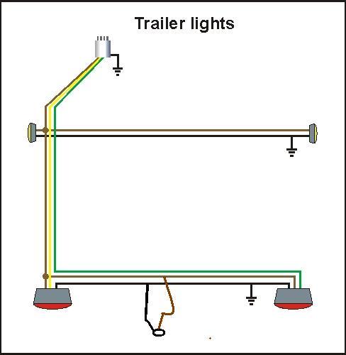

If you connect a 4 way flat connector to your car it will have 4 wires
( some have 3 but we won't go there ) The white is a ground a return path to the cars battery. A brown wire is connecter to your car tail lights. The yellow is the drivers side turn and the green is the passenger side turn. When you step on the cars brake both turn lights come on on the car so that is now the same on the trailer. I think what you are trying to ask is how in the hell do you get the brown wire to the hatch lid since it is raising and lowering. I have all tails and license plate lights mounted on the hatch. In order to do this you need to route the wires up the galley wall and near the hinge the ones you need to be on the hatch are routed down the hatch bones to the lights. Drill a small hole and route the wires to the lights as needed. You will have a brown going to both tails and the license plate a yellow to the "center line side" Drivers and a green to the "grass side " passenger side. ( apologies to those across the pond but we don't want to muddy the water any further) You have now extended your cars lighting systen to the rear of your trailer.
In order to assure uninterupted lighting you must also run the return "white " wire back to the 4 way flat or at least a real good metal ground.
Here is Joanne's wiring pictorial . I have poorly added your license plate light. The black wire is the ground wire the return wire we were talking about that is white. I know I know just trust us that the little arrow is going back to the negative side of the battery.

She wants a light above the license plate. Follow Bob Henry's instructions. I have a 4 flat to connect the hatch wires to the trailer wires. That way if I ever need to change them or the hatch I can just unplug.
Buy a light with a ground wire. Mine depended on a connection to metal so I had to create a ground. You will run your running lights the same.
Postby Kelleyaynn » Tue Feb 02, 2010 7:58 am
bobhenry wrote:electrical 101....
Exactly!!!
Thanks, Bob. Your answer was very helpful. Now it makes sense.
I'm thinking that if I put the license plate on the hatch, I might as well move the tail lights as well - probably makes the wiring easier.
