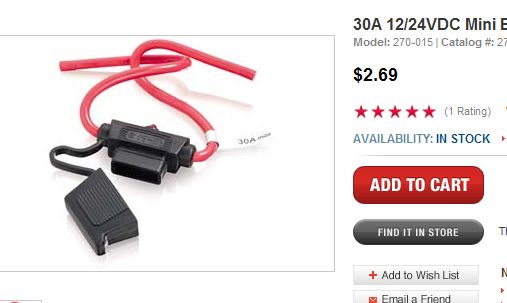

Postby Grid Runner Adventures » Fri Mar 12, 2010 11:39 pm
i was just looking at this the other day.
http://www.radioshack.com/product/index ... Id=2062258

Postby bobhenry » Sat Mar 13, 2010 3:12 am
Grid Runner Adventures wrote:i was just looking at this the other day.
That's the one I have in the pic above !

Postby Arne » Sun May 09, 2010 9:11 am
I bought an inline fuse holder for the new 2 prong fuses. It sits near the battery and has a 20 amp fuse in it... so, I only have that one inline fuse. Off it, I run several interior lights and the fantastic vent fan... Unless I stick a screwdriver into one of the light sockets, it should never blow.
Has been that way for 2 years with no problems. It isn't like a house with a ton of places that things can go wrong and 50 outlets and you have a lot of draw, it is just a couple of small lights.
