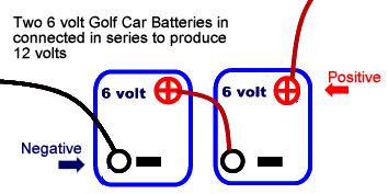

2 six volt lantern batteries ( The big square ones) hooked in series
would give you enough juice for a long test.
There are baskets and baskets of 120 v AC to 12 volt DC power transformers at most of the Goodwills I frequent for a buck or 2. Might make a less than $10.00 ac with DC backup power source.
